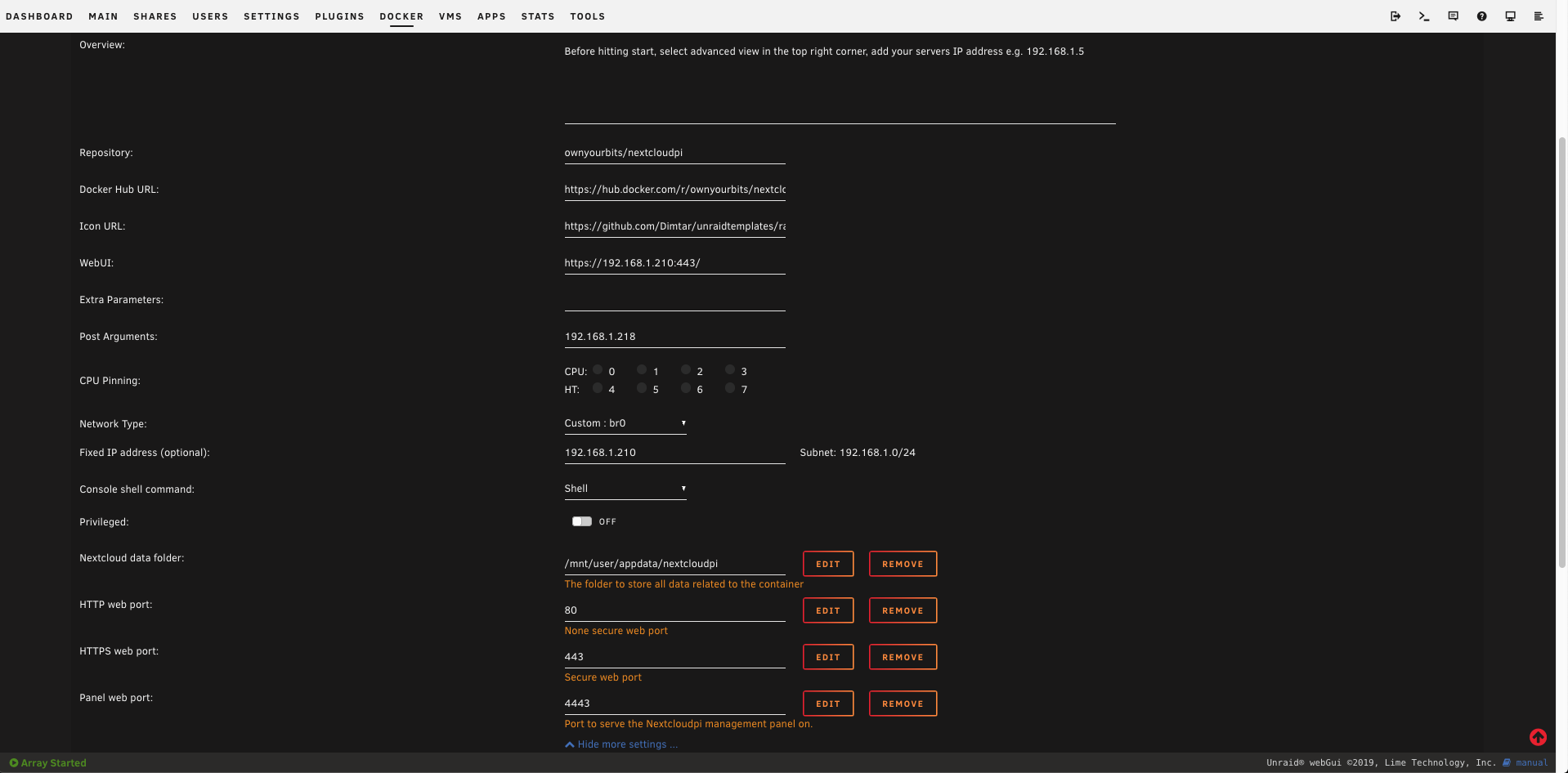

  3. Ah I see now... haha I feel stupid. I thought you meant to fill in the ip address of the unraid server. I got it to work now, thank you very much for your help!
  4. Not a problem! Hopefully this is enough information otherwise let me know! As you can see I put the webui to the static ip I assigned to the docker and as you instructed put my unraid server ip with the post arguments.

  6. superslider joined the community
