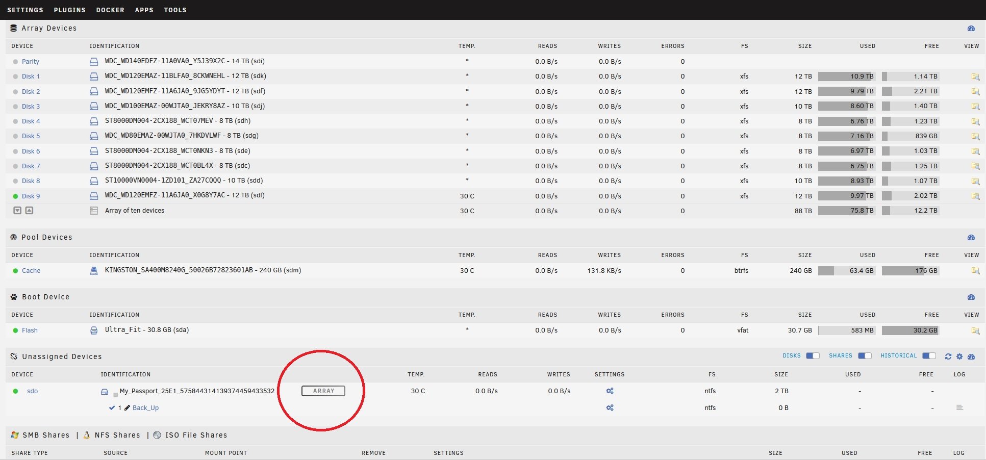

did that, uninstalled, reinstalled, didn't help.

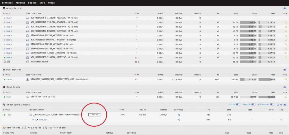

if I'm not posting in the correct section, please let me know. thanks. ever since updating Unassigned Devices a week ago, one of my previously working portable drive started showing up as "array" in UD, instead of "mount/unmount". my go around is to stop the array and re-start again, or reboot, then UD will correctly allow me to "mount/unmount" it, but then, once I unplugged that drive, do my thing with it, replug it back in, it's back to "array" in UD once more, requiring the go-around again. it's not a critical issue as there are go-arounds, but if someone knows how I can do without restarting my whole array everytime I want to transfer some files, that'd be really neat. Thanks.
