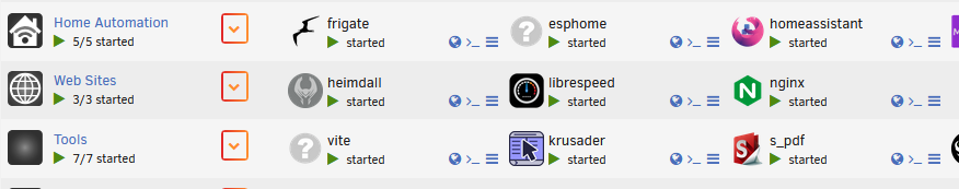

  2. There are 2x PRs that both address this in different ways. I went with a CSS only and JohannesHo went with a JS approach. Both work. My CSS approach - I also lined up the containers so they're all the same size. It's not the prettiest CSS but it works Mine: https://github.com/VladoPortos/folder.view/pull/12 JohannesHo: https://github.com/VladoPortos/folder.view/pull/11
