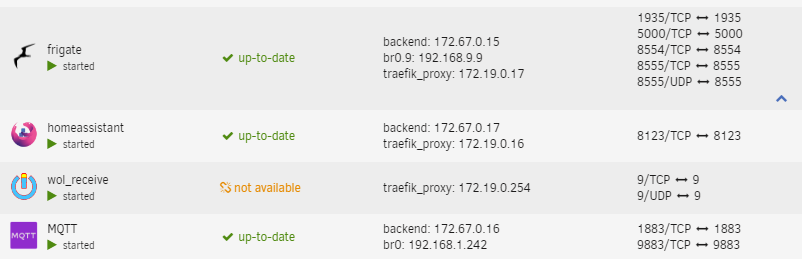

  20. I've been playing with the code behind this plugin and have made a couple of tweaks. I'd be interested on peoples thoughts and suggestions. The first allows you to specify any .env file. This allows use of a central env for all your compose files. https://github.com/dcflachs/compose_plugin/pull/24 Update the built in unRaid image versions so the GUI correctly shows updates for containers. I'm still testing this before doing a PR. https://github.com/dcflachs/compose_plugin/commit/4297b46fdfeaa077f405a328ee074606363d5f9b I've tweaked how the network info is shown in the GUI. It now shows all network names with the associated IP. This is in the dynamix.docker.manager plugin which is a core part of unRaid's GUI - so not technically part of this plugin. You need to set the label net.unraid.docker.managed: 'composeman' for this to work (this is usually done with the overide yaml). https://github.com/unraid/webgui/issues/1569 Here's a screenshot of it: I've contemplated making the network name bold but I don't think it's needed. At present, these all need to be implemented by overwriting the files in /usr/local/emhttp/plugins/. Look at the commits to see what files need to be edited.
