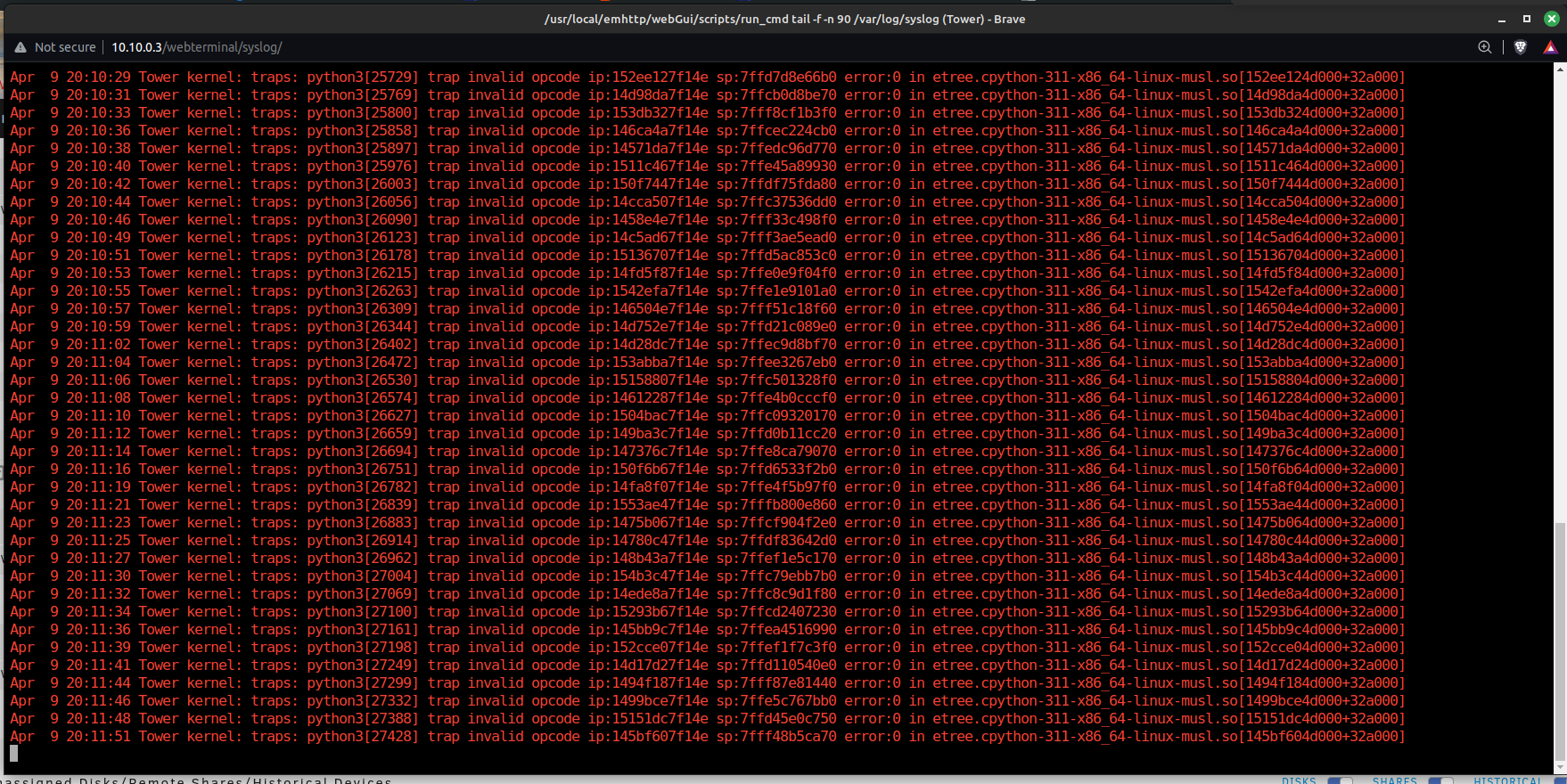

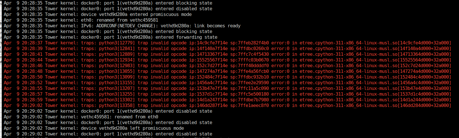

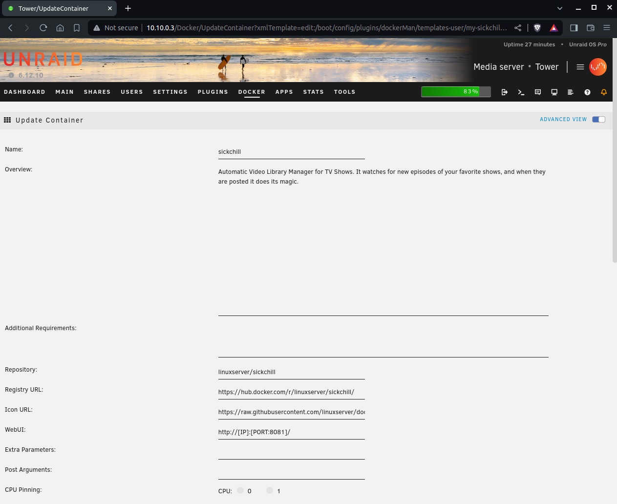

  5. I just fired up Plex to watch a few TV shows and noticed that large chunks of TV episodes were missing. When I had a look at my Unraid server I noticed that Disk 6 is acting really strange. I've had a few disks die on me, but I've never had this happen. In the Unraid UI the file contents of disk 6 - rather than listing my shares - seems to be listing the contents of the underlying OS root! This can't be good. When I bring up a terminal window and use mc tolist the contents of /mnt everything appears AOK except for disk6 which is listed in red and has a question mark in front of it! When I double-click on "disk6" mc states "Error: Cannot read directory contents" This can't be good. I am crossing fingers, hoping that if I do a reboot my Disk 6 will magically re-appear... My syslog looks like this: I have dumped the diagnostics file. Looking at syslog1.txt I can see lines like this: May 28 18:24:37 Tower kernel: XFS (md6p1): Corruption detected. Unmount and run xfs_repair I just watched SpaceInvader One's video "How to fix XFS File System Corruption on an Unraid Server" and I am starting to feel a little bit better. Before I commit to the XFS repair I was hoping the Unraid brains trust could chime in and let me know if I am heading in the right direction? Cheers, Jaso tower-diagnostics-20240529-1811.zip
  6. Solved by rolling back t previous version, by changing the template entry for 'repository' from linuxserver/sickchill to linuxserver/sickchill:2024.3.1-ls192

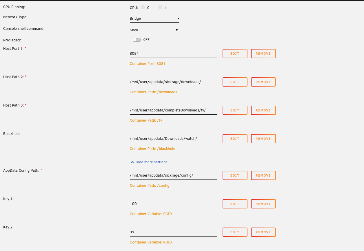

  7. Like the title says, sickchill won't start since the last sickchill update. I have updated Unraid from 6.12.9 to 6.12.10, but it still won't start. The following errors where appearing in my Unraid syslog, before and after the upgrade of Unraid. I have confirmed the errors are sourced from sickchill by starting and stopping each docker. The errors only appear when sickchill is started (and stop when sickchill is stopped): Apr 9 20:57:32 Tower kernel: traps: python3[11080] trap invalid opcode ip:15276047f14e sp:7ffc5821ba10 error:0 in etree.cpython-311-x86_64-linux-musl.so[15276044d000+32a000] Apr 9 20:57:34 Tower kernel: traps: python3[11220] trap invalid opcode ip:148d0ee7f14e sp:7ffd670c8300 error:0 in etree.cpython-311-x86_64-linux-musl.so[148d0ee4d000+32a000] Apr 9 20:57:38 Tower kernel: traps: python3[11325] trap invalid opcode ip:14c0dca7f14e sp:7ffec052d360 error:0 in etree.cpython-311-x86_64-linux-musl.so[14c0dca4d000+32a000] Apr 9 20:57:42 Tower kernel: traps: python3[11418] trap invalid opcode ip:146ccec7f14e sp:7ffdcacc9050 error:0 in etree.cpython-311-x86_64-linux-musl.so[146ccec4d000+32a000] Apr 9 20:57:45 Tower kernel: traps: python3[11550] trap invalid opcode ip:14d71687f14e sp:7ffe90072fc0 error:0 in etree.cpython-311-x86_64-linux-musl.so[14d71684d000+32a000] Apr 9 20:57:48 Tower kernel: traps: python3[11640] trap invalid opcode ip:14a154e7f14e sp:7fffe7b38550 error:0 in etree.cpython-311-x86_64-linux-musl.so[14a154e4d000+32a000] I have attached screenshots of: * unraid logs * sickchill docker settings * sickchill logs I am assuming it's probably some silly config setting I am neglecting, but I just can't figure it out. I would be great if someone can point me in the right direction. Cheers, Jaso
  8. Just wanted to do two things: 1. A big thankyou to itimpi for the unRAIDFindDuplicates script. I have had a few copy/move errors over the last decade and itempi's script just found nearly 400GB of dupes scattered over my 42GB unraid array. 2. I banged together a little script that looks at the output of the itimpi's script, and deletes the dupes. Note that you must do a bit of cleaning of itimpi's output file first - delete everything except the file paths. That is, remove the lines at beginning of duplicates.txt that look like this: (also delete file size warnings, and the lines for files associated to the warnings) COMMAND USED: ./unRAIDFindDuplicates.sh Duplicate Files --------------- Here is my script - I called it 'delete-dupes.sh'. Execute it like this: bash ./delete-dupes.sh '/boot/duplicates.txt' #!/bin/bash # Check if the file exists if [ ! -f "$1" ]; then echo "File not found!" exit 1 fi # Read the file line by line while IFS= read -r line; do # Check if the line is empty if [ -n "$line" ]; then # Prepend "/mnt/user/" to the line path="/mnt/user/$line" # Delete the file path rm -v "$path" fi done < "$1" Be careful. If you execute the delete-dupes script twice in a row it will delete the remaining (now unique) files. I had thousands of files that were duplicated, without the script I would have been manually deleting duplicate files for weeks. Thanks again itempi!
  9. Sickchill died for me recently after updating to latest docker version of sickchill via unraid docker screen "check for updates" button. I am on Unraid 6.9.1. Sickchill container ID: 46be26380d7a. I have restarted the sickchill docker a few times but no joy. Any ideas? Edit: I also tried editing the docker config to run sickchill in "Privileged" mode. Still no joy There are a few errors appearing when I view the logs: warnings.warn("urllib3 ({}) or chardet ({})/charset_normalizer ({}) doesn't match a supported " Checking poetry sickchill installed: True /usr/lib/python3.9/site-packages/requests/__init__.py:102: RequestsDependencyWarning: urllib3 (1.26.7) or chardet (5.0.0)/charset_normalizer (2.0.7) doesn't match a supported version! warnings.warn("urllib3 ({}) or chardet ({})/charset_normalizer ({}) doesn't match a supported " Traceback (most recent call last): File "/usr/bin/SickChill", line 8, in <module> sys.exit(main()) File "/usr/lib/python3.9/site-packages/SickChill.py", line 345, in main SickChill().start() File "/usr/lib/python3.9/site-packages/SickChill.py", line 90, in start settings.DATA_DIR = choose_data_dir(settings.PROG_DIR) File "/usr/lib/python3.9/site-packages/sickchill/helper/common.py", line 404, in choose_data_dir if location.joinpath(check).exists(): File "/usr/lib/python3.9/pathlib.py", line 1424, in exists self.stat() File "/usr/lib/python3.9/pathlib.py", line 1232, in stat return self._accessor.stat(self) PermissionError: [Errno 13] Permission denied: '/root/sickchill/sickbeard.db' EDIT 2: A new image of sickchill was released [Image ID: 357610432]. Pulled new image. Everything fixed.

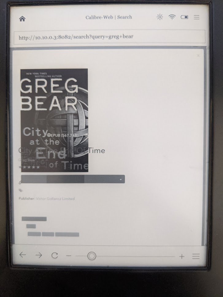

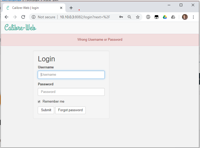

  10. The Jquery Web-UI is a bit too fancy for my ebook reader (Kobo Aura H2O). I can see some bits of the UI quite clearly but the bright blue bar that contains the downloads link renders as a grey blob on the Kobo. Nonetheless on the kobo I can't actually initiate a download to my e-reader. Dees anyone know if there is there is a simpler, old-fashioned URL I could hit to view a much simpler version of the UI?
