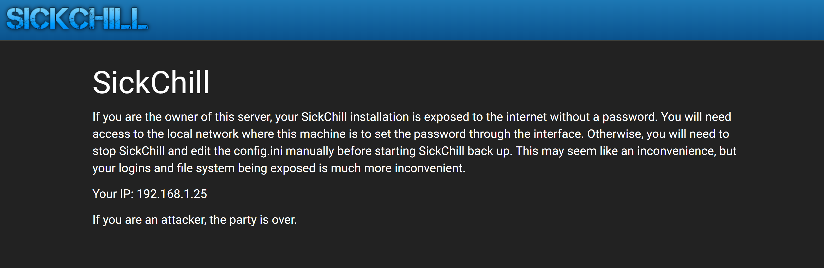

June 15, 20206 yr 13 hours ago, xtrips said: As of this morning Sickchill is blocked Do you expose it to the internet without a password?
