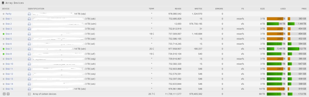

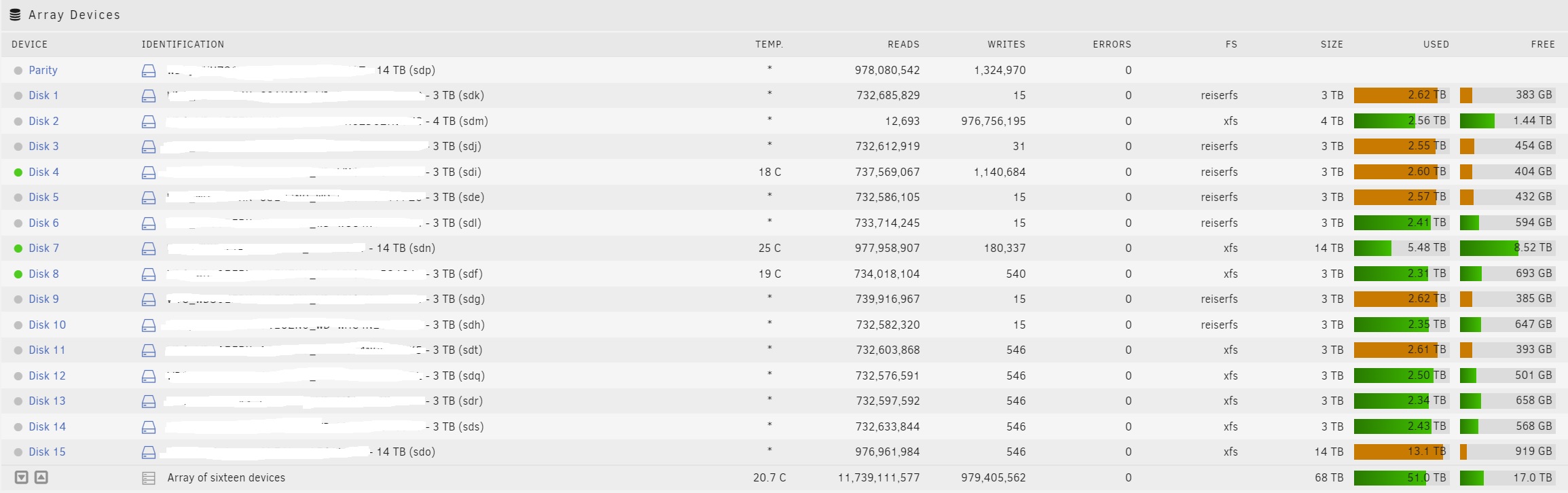

  15. It's time to give this a go! I have x2 14TB drives arriving today, so i thought i would start moving some data around with what space i have whilst i wait. 1) I would like to replace disk 1 (as that's the oldest) with a new 14TB drive, but formatted to XFS. 2) Once that is in place i will be able to copy the data over from other 3TB drives, remove them from the system and then add the other 14TB drive. I do not have any further sata ports, so i will need to remove a drive (1) before i can add a new one. What would be the correct procedure to accomplish part 1? In order to remove that drive (1), i will need to copy over the data to make it empty? Many thanks for your help! Part 1) Replace disk 1 with new 14TB drive and formatted in XFS. **I have the unbalance plugin to copy (instead of move as per your suggestion?) and there will be no other activity happening on the server whilst this completes**
