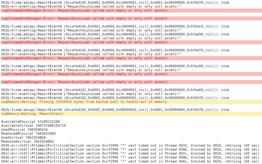

  9. I guess Wine is just not compatible when the game gets more ressource hungry, because i added 2 big mods and the game wont even start. my solution now is that i created a windows VM, copied the files and the same server just works fine.

  11. i guess, but i dont know if there is a max ram error that the emulator have, because mods need more ram. and we play with 9 ppl that are at different places all the time. i only have 1 big mod: -The Age of Calamitous ~1.4GB and 5 very small ones: -Less Building Placement -ChestStorage+ -automatic fish trap -Pickup+ All Mods are still maintained and work with the newest conan version. there should be no conflict with each other. the crash only appears when the server is running for like 6-12hrs or so
  12. Hey Ich777, Sorry for posting so often, i am using your Conan Exiles server for a week now, i installed a few mods and i get out of memory issuses sometimes. do you have any clue what to do? i know the server is running in an emulated windows enviroment. but i dont know what to do. i have 64GB ram and the container is not using all of it. i have to manually restart the server if this happens

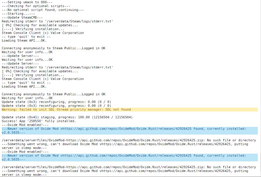

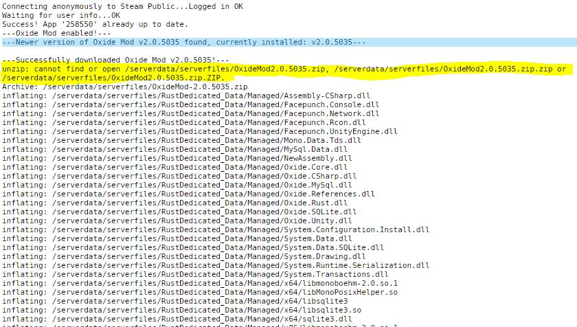

  13. It works fantastically! Thank you. i guess i can ignore this file not found message because the installation was successfully anyway ?

  15. No it’s normal, Oxide Needs to overide the Original gamefiles to work. Everything Else like the Plugins you install stays. If Theres an Update These files will be set Original again and no validation is not set to True. tutorial: https://clients.mcprohosting.com/knowledgebase/279/How-to-Manually-Install-Oxide-to-your-Rust-Server.html this guy also mention that if you Update the Game you have to reinstall Oxide. this Tutorial is for their Website but you will get it, Its just extracting the zip into your gamefolder and Override the existing files. You start the Game as normal Expect that you can install mods/Plugins
  16. hey, is there any way to add oxide to your rust template? i mean like you did it in Valheim. If theres an update on rust (what happens quite often latley) Oxide(Umod) everytime gets overritten and you have to manually download and install it again. its pretty tricky if your at work and your friends want to play and you cant to anything. basicly the same you did with Valheim Plus. download the newest version from https://umod.org/games/rust and extract it to the gamefolder greets
