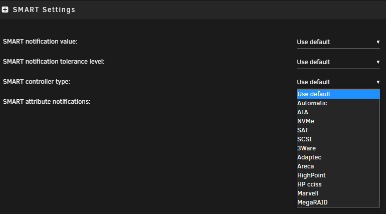

/dev/sdk: requires option '-d cciss,N'
Please specify device type with the -d option.
Use smartctl -h to get a usage summary
I think this is because the array is SAS disks, so smartctl needs the "- d scsi" flag set - but I dont know if (or how) this can be set in UnRAID.

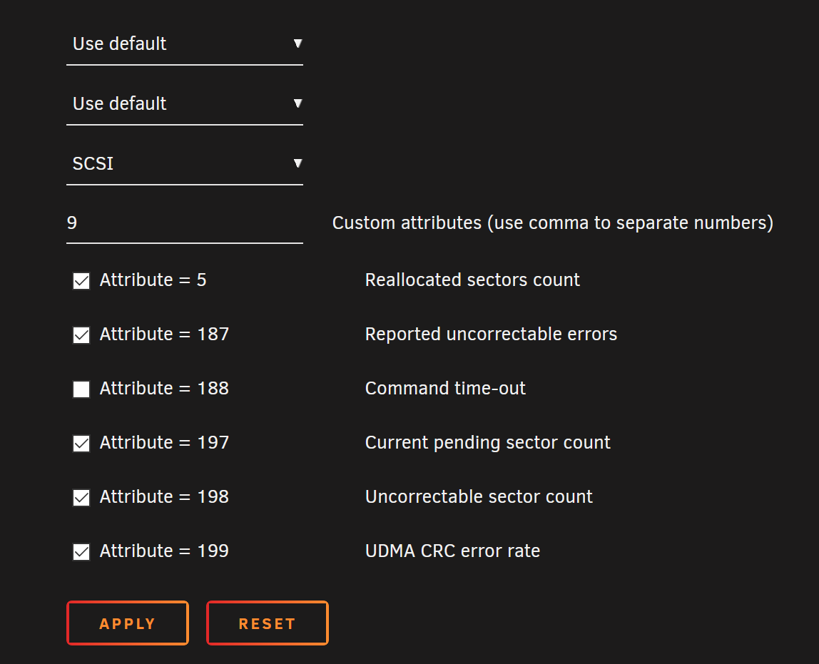

Do you know how to add SMART attribute 09, Power on hours? I wrongly thought I could add 9 as a custom attribute;
Those are the monitored attributes.  You really don't want to add POH as a monitored attribute as you'll get a notification every hour.
Did you try the HP cciss option?
I hadnt... when I first tried it, it just came up with an error - till I realised that disk 9 is actually disk index 8 as it goes from 0-15 on my 16 disk array 🙂
Once I put this right, it did download a SMART report... but still no POH 🤔
