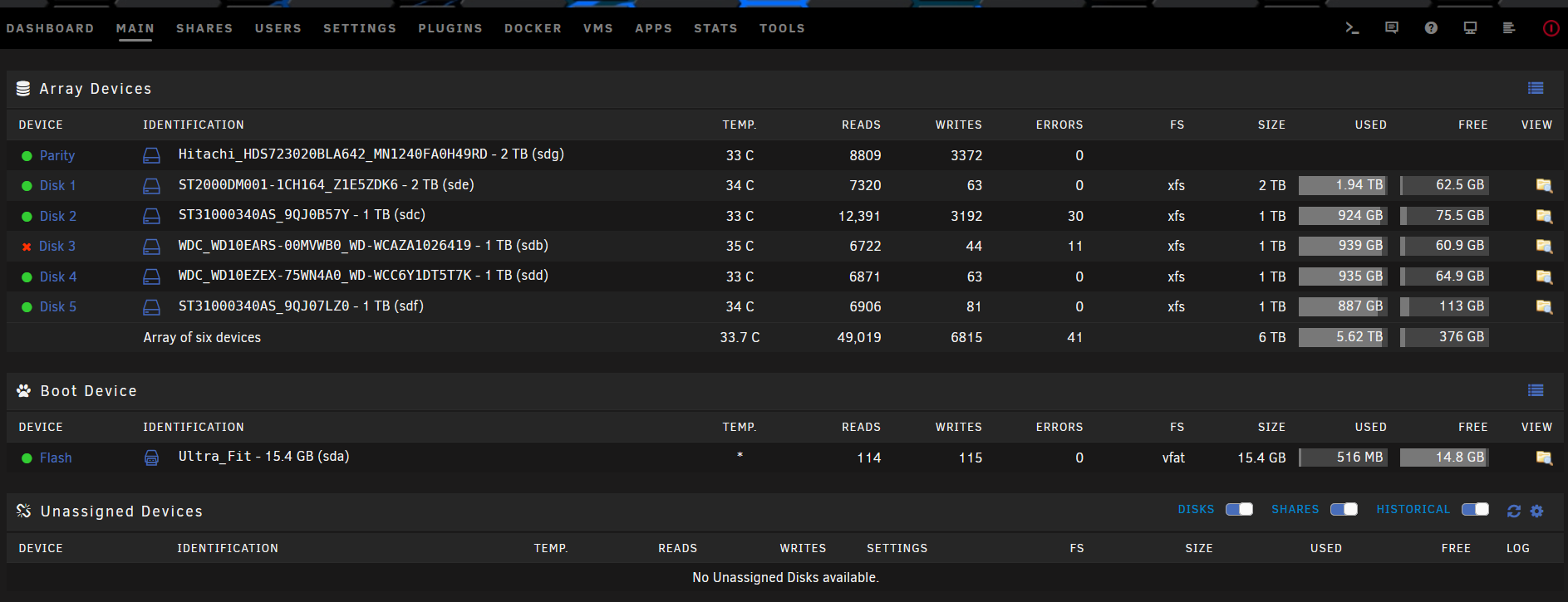

Diagnostics is showing all disks mounted now but disk3 is disabled. Does that agree with what you see in Main - Array Devices?
And smart is showing disks 1 and 3 disconnected, syslog agrees.

Yes, the screenshot above is fresh, disk 3 is offline. Seems like everything is going wrong now.. first disk 1 not 2&3
I suspect a power or controller problem since multiple disks are involved.

My server uses a rackmount case with no sas backplane, it just has regular SATA connections so no pci sas controller, My power supply is triple redundancy single rail so the problem would be on all drives if it was a problem with the 12/5v rail. Is it possible the problem is with the motherboard?

Are all of the SATA connections on the motherboard? Have you checked for a BIOS update?
Yes, all 6 connections are directly on the motherboard, I am on the latest BIOS update
Onboard SATA is set to IDE, set it to AHCI, though that just by itself shouldn't cause disk errors it's not good for performance/reliability and issues with one disk can affect the slave or master on the same channel.
