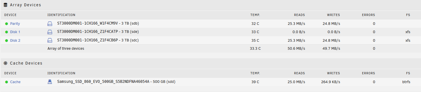

December 31, 20205 yr Same thing here. Writes to the cache as full speed (max spinning drive speed reads). Then when I hit the Mover button (below image) I only get 25MB/s. is this normal? the system isn't doing anything else such as a parity check. though the parity drive is active.
December 31, 20205 yr Community Expert You can enable turbo write for better performance, at the expense of all disks spinning up for writes.
December 31, 20205 yr I've read some more and have a better understanding why this is happening. I looked at the APP for Turbo Write Schedule and that looks interesting. But as the Mover is doing its work at midnight on this might not be an issue for me. Its only when I'm doing an intentional move that it becomes an issue. Thanks for the reply. Jay

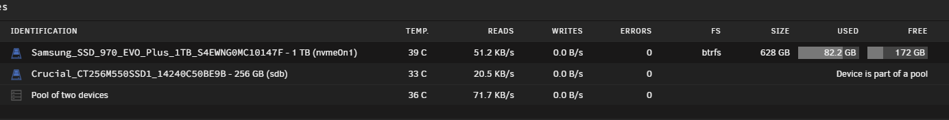

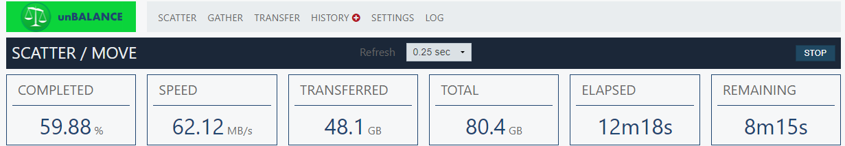

July 21, 20224 yr Thanks I started mover, but that will take a week. Is it safe to reboot and tro to move files with unbalance instead? I just wanted to swap out the the 256 GB SSD witg a NVME but it did make a pool. I just hoped it did a mirror and i could remove the old one, but wasnt possible. I just rebooted the array and hoped for the best. Going so much faster with unbalance in turbo write mode Edited July 21, 20224 yr by ajugland Found a solution
August 25, 20223 yr With unbalance it made some of my files corrupted so I cannot trust unbalance for mover moving bitwarden files. Anyone got a fix to really slow mover? LIke 100 kb movement everyt minute only. When its 100 gb it will take years.
