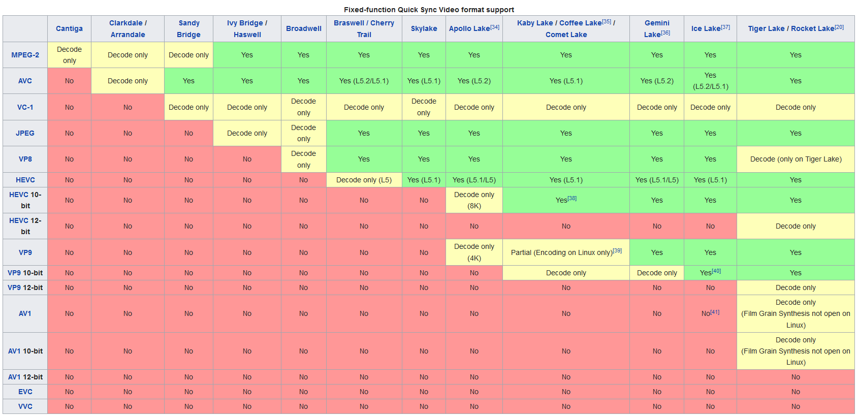

If Intel, what generation 9 or 10? (Remember the quick sync)
Any recent Intel CPU generation (Kaby Lake or above recommended for 4K/HEVC) ) with QuickSync will be fine.  Here's a handy chart that shows each generation's capabilities:
