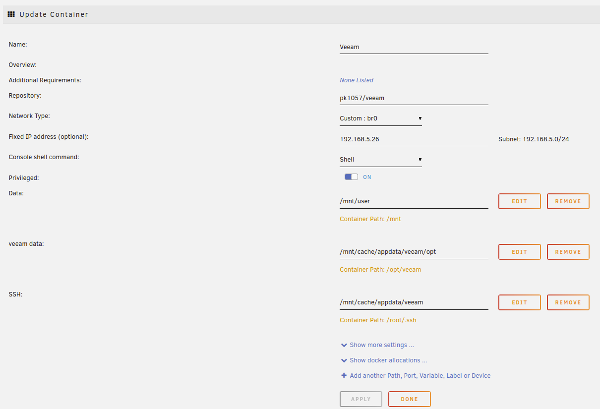

Yes I put your DNS name but I add docker with IP address.
Files seems look ok.
Yes container is in privileged mode and I can connect to SSH. Network is br0

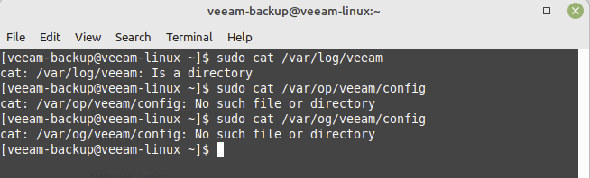

I cant see log files. I give no such file or directory.

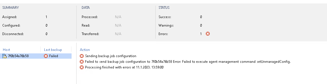

Again I have error OS not supported and cant upgrade veem agent on container. I dont know where is problem everything looks like your screenshots.

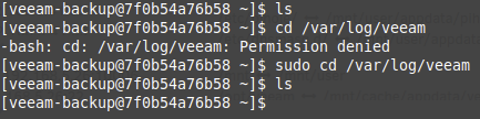

/var/log/veeam and /var/log/veeam/config are directories so you have to do a ls and then there resides some files insider where you can cat.

I use only ip. Now I removed DNS name of docker.

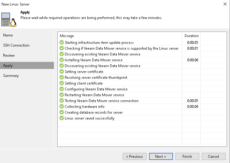

Yes I add user veeam-backup in credentials on veeam.
Yes i can reach container and log in sucess via ssh.
But when i try to access to map with log give me permisson denied.  I try with sudo but map not open.
But when I add docker in veeam all is ok same in your screenshot. But when i setup file level backup and add /mnt/user/appdata for test veem tell agent upgrade is needed and I give error os is not supported.

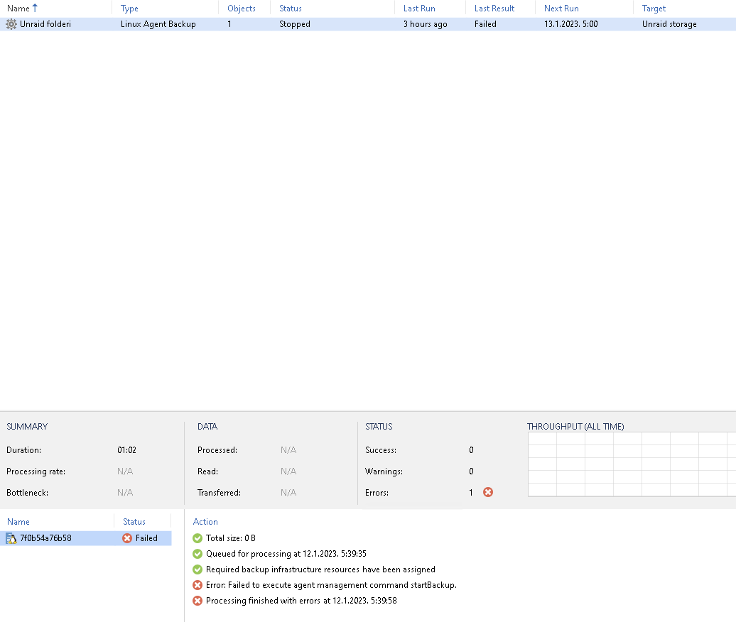

This error I have

Now I setup job as you. Job Mode Type Server, Managed By Backup Server.
But again error but different.
