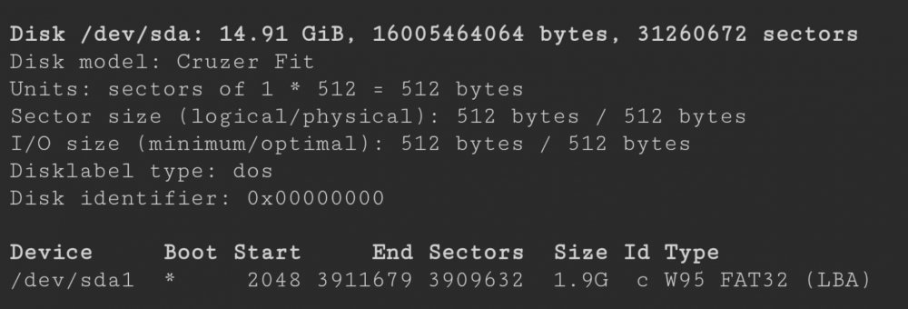

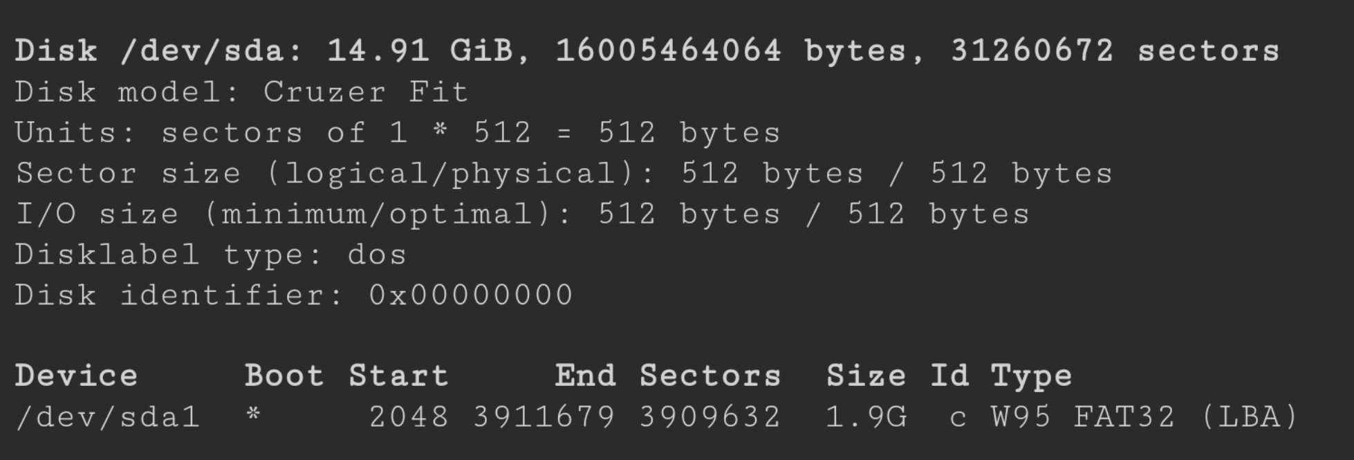

Report as promised, @squid. Linux seems to think this is kosher.
But, of course, Linux (and Windows) would only be reporting what the USB controller announces. Does UnRAID have a more thorough way of probing the NAND?
Chris

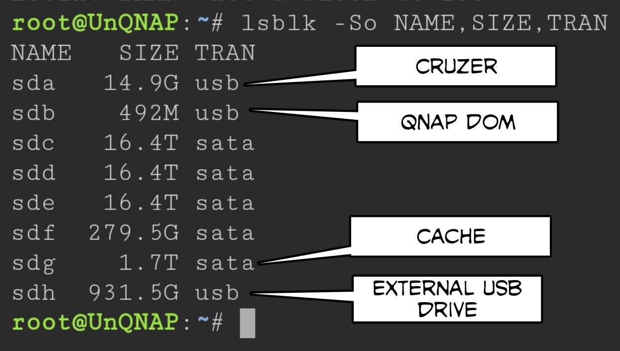

What does the 'lsblk' command under Unraid show?   Note that 'sda' is the whole drive and so it is still passible for there to be a partition (sda1) present that is not the whole drive.
By golly, @jonathanm and @itimpi, you guys are right. So, many thanks.
But why would the UnRAID USB Creator do this to a 16GB drive? Doesn't it begin with a FAT32 format? Or does it use the existing FAT32 format (in which case, probable user error).
Perhaps more to the point, what's the best way home from here?
Leave it alone? I don't see any benefit, and plenty of ways to screw it up.
Granted, it wouldn't be that hard to fix, but what would you gain? You are currently only using a little over 1/4 of the allocated space. If the USB firmware is intelligent, it will use the remaining capacity behind the scenes for wear leveling anyway. Think of it as a little aggressive over-provisioning that should extend the life of your device.
If you do start to run close, address it then.

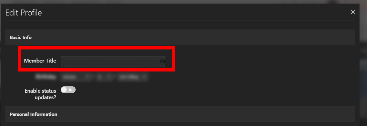

Click on your name at the top of this page, profile, edit profile, member title.

I can't find a field called "member title" on the edit profile page. (Shows how completely I'm not an Advanced Member...).
Chris

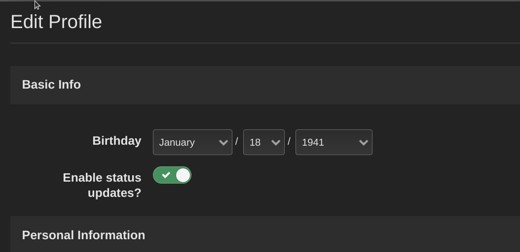

I think the ability to edit that field must be an earned privilege I've yet to achieve, @ChatNoir. I can find no such field in my profile.
Chris
