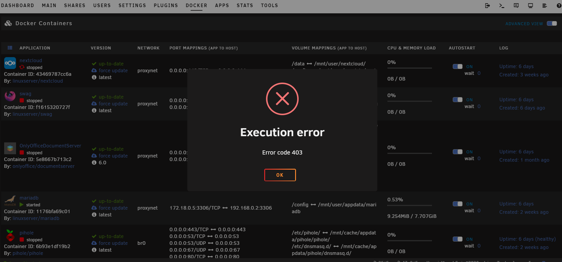

[Solved] Docker Execution Error: Error Code 403
I am not sure what is the issue here. All my docker stop working. And everytime I try to restart it, it gave me this error code 403. I read some forum said is the log file is too full or something. Can anyone help me with this? I attached the system log file below. Let me know if there any other log file you want to see through command line. Just a headups, I am not good with command line.

Hi, thanks for the reply. After I rebooted, everything goes back to normal. I was worrying if I reboot, my file would get corrupted after reading some old forum about cache drive been full. But clearly, it wasn't the case.
For future reader, this issue arrive when I was transferring a single big file into my cache drive without realising my cache drive is full, which cause an internal error in my Unraid server. After I invoke the Mover, my cache drive is clear up. Then, I rebooted my server. It all went back to normal operation.

So i have the same probleme. All apps in 403 error. Cache 100 % (250Go).
I installed the mover plugin, and set a threshold to 70%. Cache is back to 70 %. But still no app is working.

Post new diags after array start, problem was likely caused by the pool getting completely full
  • 1 year later...
You can fix this without even restarting by turning Docker off and back on via Settings > Docker
