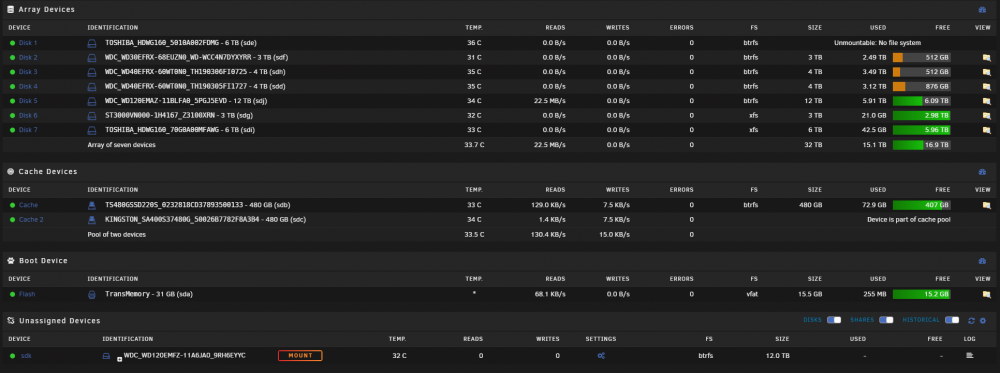

Sorry just saw this after one long night of reconfiguring my unRAID server. yes someone from limetech did issue me a new license shortly after sending them my new flash drive's GUID. However, now I'm having some issues as it seems my parity drive isn't recognized in the array and Disk 1 shows up as Unmountable : No file system :/
Any help would be appreciated! Though most files would basically be linux ISOs on Disk 1 and *Cross fingers* I've had most of the important files backed up on my office NAS.
Also I'm having some issues with my configuration as it seems I'm unable to map & connect to my 10Gbe network on windows. Not sure if this is the right place, but have uploaded my diagnostic files here tooimage.thumb.png.e4449a6890af438a8316a1567c2821ba.pngchongclan-diagnostics-20210204-1158.zip
