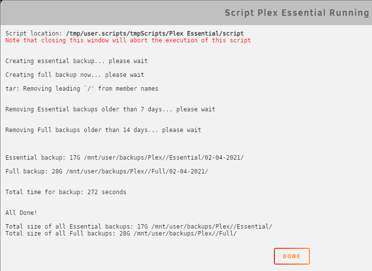

February 4, 20215 yr Originally I used a simple 2 line script to only back up the Plex databases since I excluded Plex from CA Appdata Backup because I didn't want nightly backups with 20GB+ of Plex metadata. That idea sparked @Cpt. Chaz to further modify that basic idea with some improvements and a great @SpaceInvaderOne-type video on YouTube showing the implementation and use of his script. His version of the script gave me some ideas on improving my original version, which led to this new version. A lot to follow, right? The main difference between Cpt. Chaz's script and mine is that I use a tar archive for backup and he copies the files, which can easily be changed to using tar if you wanted to. I also back up the Plug-ins preferences directory which includes settings for scrapers, plugins, etc. Then I took it a step further (for fun, and learning) to not only back up the important Plex data but to also have the ability to create periodic full Plex appdata backups (like you'd ultimately get with CA Appdata Backup). I run CA Appdata Backup nightly but I do not need or want full Plex backups every single night, so this is my solution. If you run the script manually you'll end up seeing something like this... I just created a fresh set of backups. Find the script here and you can contribute to any changes / fixes. https://github.com/rcodehub/unraid-plex-script Enjoy!
