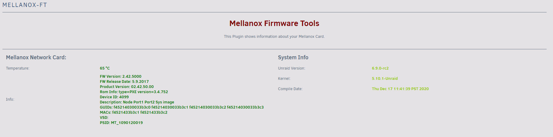

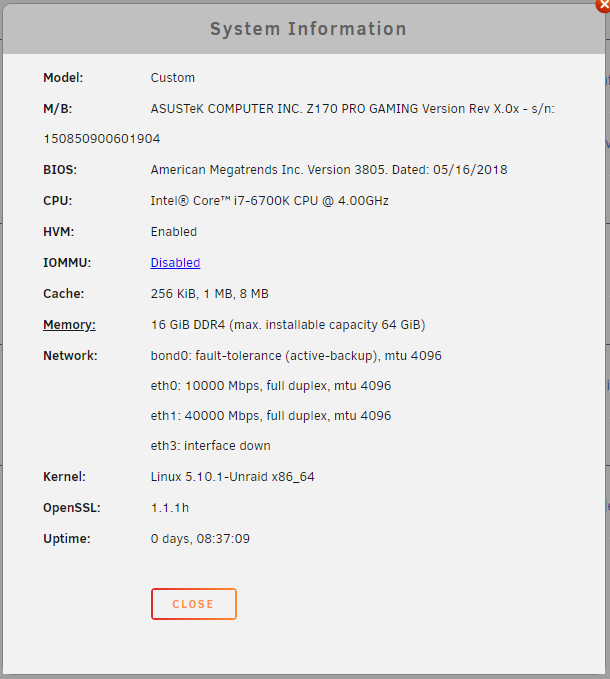

System Information:
Mellanox Firmware Info:
