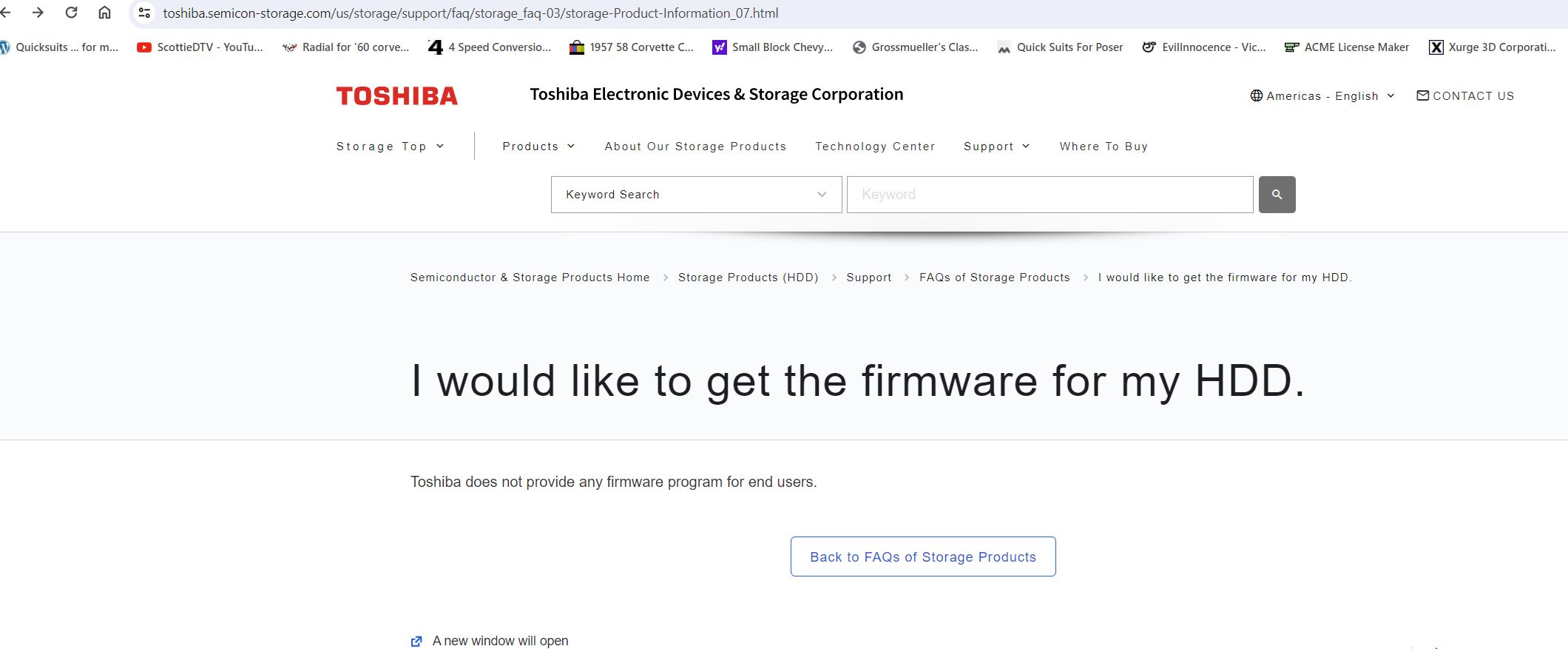

Where can firmware updates for Toshiba hard drives be downloaded? I've been searching for a few days and can not find anything.
