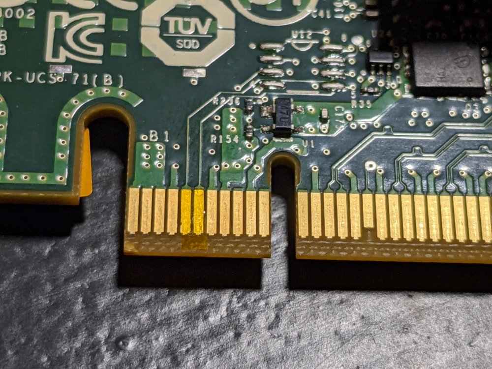

1. Pls check does it detect at Unraid system device.
2. Does HBA heatsink hot ? If not, it should be dead.
3. Pls try tape B5 B6 at HBA pcie contact finger.
Edited by Vr2Io

Thanks for your reply. As stated above Unraid does not see the card. There is no mention of it in the devicelist.
The heatsink is cold. It does not warm up.
I have tried that but it doesn't work.
I have got another motherboard to start the efi flash but that just tells me that it can't find an LSI card. It does appear that the card is dead.

Did you actually kapton tape B5 and B6 like Vr2lo suggested?  Some cards such as Dell cards require you to in a non dell system.
I saw that I never replied to you.
The cards were dead. Turned out that both had burned some kind of fuse on them. Someone repaired them for me and I have one of the cards working for a few months now. The other is a spare.
