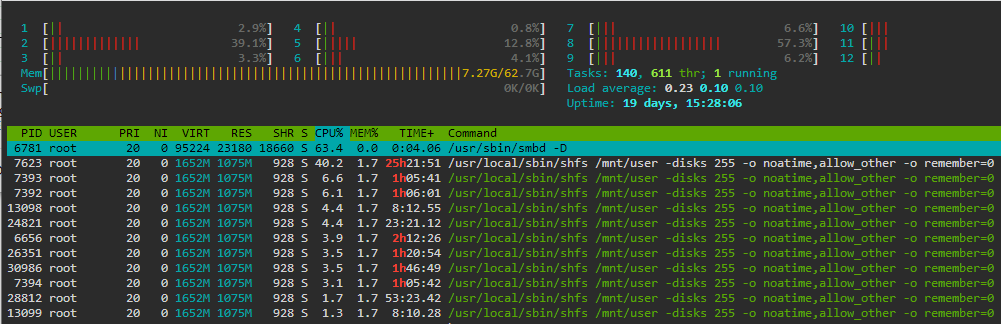

You can simply test it. Transfer a file to a share which uses Prefer and check your CPU load with htop (130 - 200 % load):

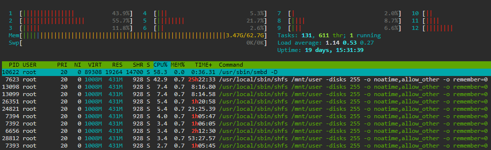

Now do the same with a share which uses Cache-Only (130 - 200% load):

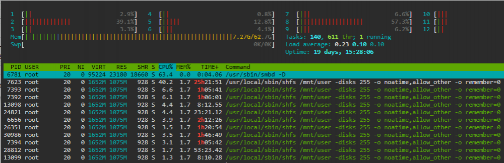

And if you now copy a file to this new share, it directly points to the cache pool and bypasses the FUSE overhead (90 - 130% load):
