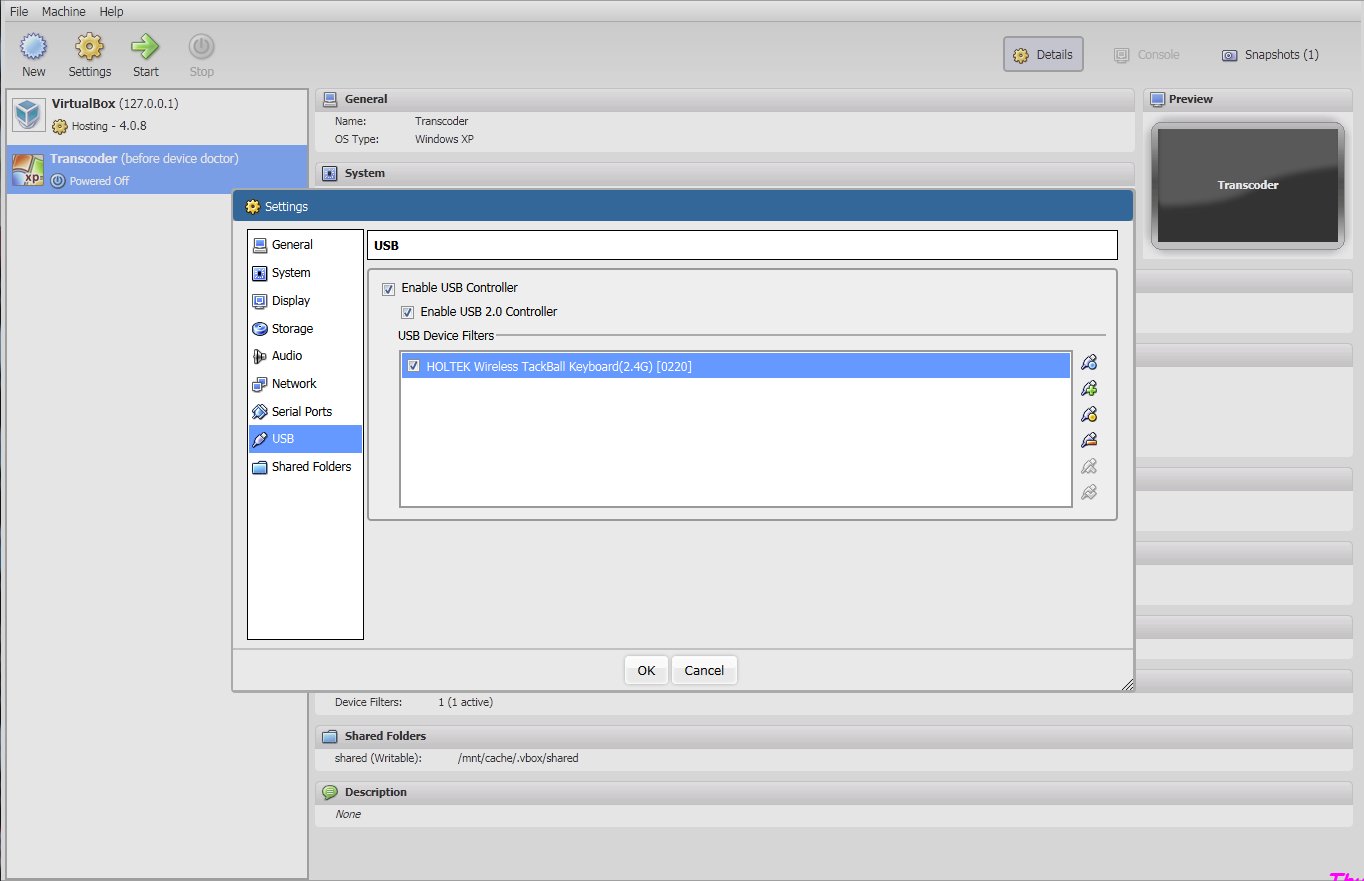

Another question:
How can I use the keyboard and mouse to do the setup ..?

I'll reinstall VirtualBox and check the options for adding the USB filter driver to a VM (under the USB section for the Virtual Machine I think)
on the to do list last time I looked they were working at adding VNC for ways to access the Virtual Machine's console.
Bobby
Here are the USB settings with a USB trackball keyboard attached
Another question:
