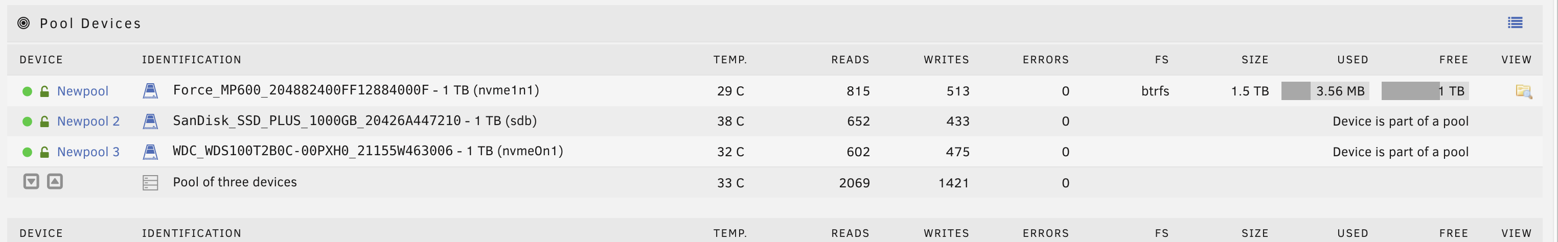

Hi Sorry, for reviving an old thread. I have an issue with my Unraid cache pool.
I have 3 1TB drives running in BTRFS Raid 1 configuration. I was expecting the total stoarage to be 1.5TB. This seems to be correctly displayed in the Size column, however once adding up taken and free space, I only have 1TB of space. Am I doing something wrong?

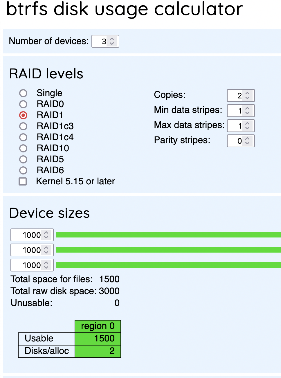

Using the BTRFS pool calculator which I have found on one of the other threads, the suggestion is that I should have a total drive of 1.5TB. Am I doing something wrong here?
Any suggestions?
No, BTRFS RAID is reporting free space wrong on pools with an odd number of devices. Not much you can do about it. :/
