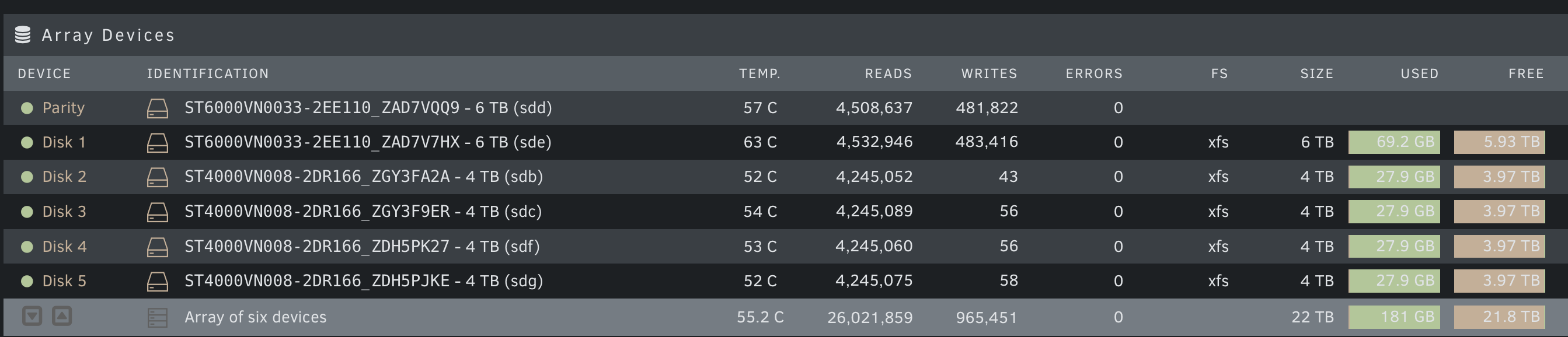

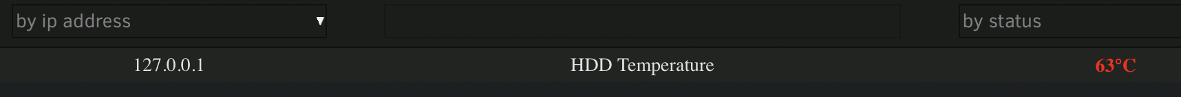

I am new to Unraid and have only just set up a system. The hardware is almost completely new except for the hard drives which I have recovered from my Synology NAS. These are less than 2 years out and in the Synology never noticed a problem but in unraid one of the data drives is showing a heat problem. The temperature rises to >60° and so I get constant notifications. Can I just stop the array for now, take the drive out and then restart the array until I get my new drive? Will I also not lose any data or vm or whatever?
Thank you.

If you take out disk1, then disk1 will in emeluate state and if one more disk failure then you will lost protection. If later, you insert a disk then it will rebuild it.
BTW, its not disk issue, its cooling issue, parity disk also in high temperature and others also in mid high, pls fix it first.
All disk usage quite low, are you transfering data now ? Pls stop until cooling issue fix.

Most drives are pretty hot, you should improve cooling.

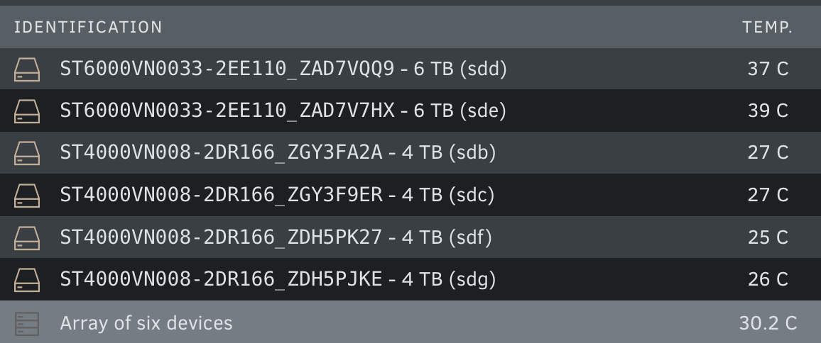

Checked the cooling last Saturday and there was a problem with the fans. Everything checked and fans turning full speed around and everything is ok now.
Thank you for the tip.
