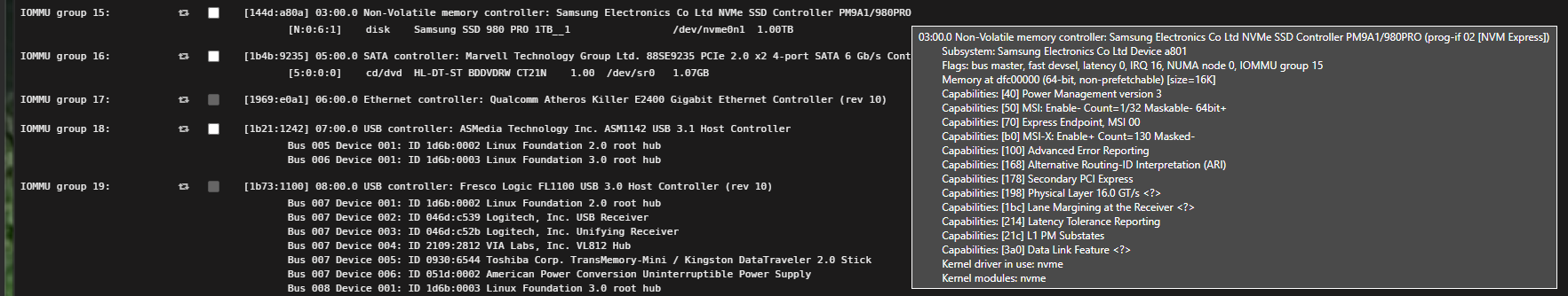

If I reboot the machine I can see the drive in Unassigned devices and even access it… and when I look at the System Devices Page I see:

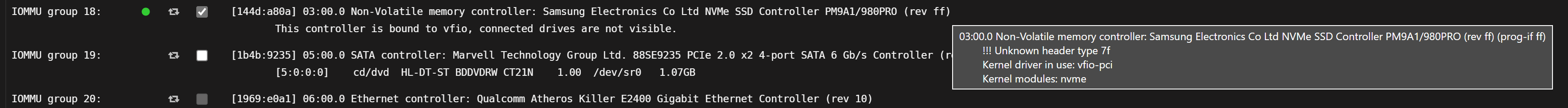

But as soon as I try to launch the VM  I get the error and the detail page changes to:
!!! Unknown header type 7f

For me (unraid 6.9.0) on System Devices page I check the NVMe drive i want to passthrough:

that's what I got when the 660P was working correctly... I've tried blocking it out by binding it to vfio... but that gives the same error followed by the difference in System Devices after I attempt to launch a VM.

Your device is not attached to vfio; I don't know if you changed something from your first post to your last one, but in the first screenshots there's no check next to the nvme controller and the output of lspci clearly shows that the nvme is using the "nvme" driver: you must read vfio, not "nvme".

I'm a little confused... You're right I had not bound it to the VFIO before... I believe that was prior to the newest unraid version, with its easier binding, and I was manually attaching it to the VM in the xml file... I notice the system reports unknown header type as soon Is I log into the gui as opposed to waiting until after I try to run the VM...
