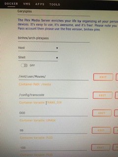

Right now its  setting up shareing for movies and Tv shows. and I do not see these folders when I try to add them to my plex library.
I am attaching my settings. It looks like if set up access to plex from outside

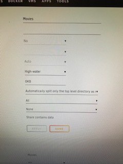

I did share all three disc with movies and tv shows
Do you mean you have enabled disk sharing and you are allowing direct access to the disks over the network? I recommend not sharing disks and only working with user shares,
Instead of posting photos of screens, please post screenshots.
But what would be more useful in this case would be the docker run command as explained at this very first link in the Docker FAQ:

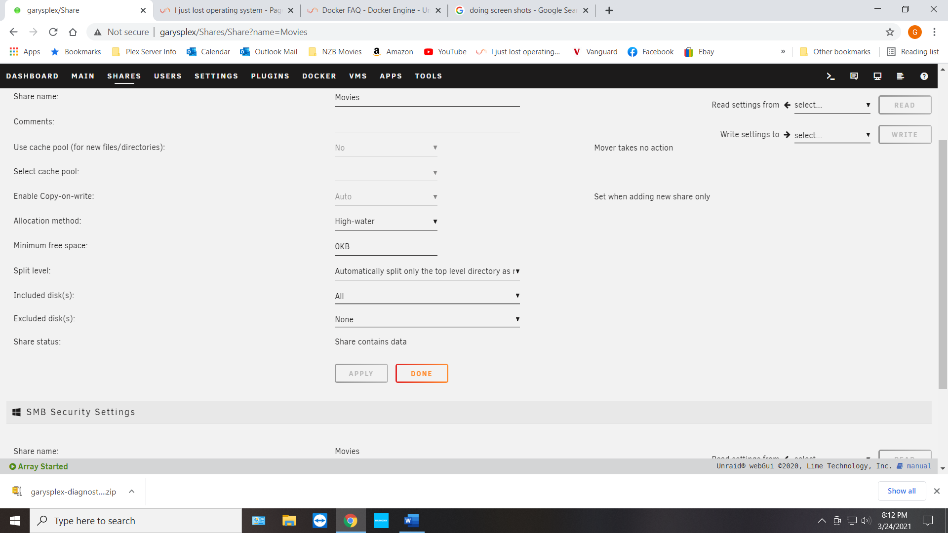

see this is the problem with me not being savi to this just frustrating. Under included discs it says All
That's fine. Currently only disk1 has contents for those shares but other disks will be used when needed.
this better?
yes, now what about that docker run?
