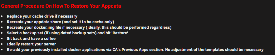

So i've been playing around and noticed something.  rootfs has 16g but when I do an appdata restore it filling up and giving me that error of no space on disk. this is how it looks when i rebooted the server again. i am assuming that it is the same issue when i copy my VM over to the unraid server.

Appdata restore has to save the log somewhere.  If docker is enabled, then it saves it on a drive (inside the docker.img file)  If it's not enabled then it has to store it in RAM.
Docker is enabled but it still seems to be using rootfs
