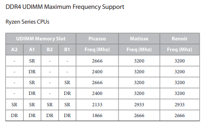

As for the memory speed question earlier, I'm running a Gen3 Ryzen so it supports 3200 MHz, which is the speed of the memory I purchased from the QVL (4 x KSM32ED8/32ME).
Not with four sticks of dual-rank memory. It's too heavy a load for the memory controllers to drive at that speed. The spec is 2666 MT/s.

You are correct sir.  I was looking at what I'm running now, not what I was running before.
And it's a lot more stable now! Diags look good. Page 22 of the manual: https://download.asrock.com/Manual/X570D4U-2L2T.pdf

4 hours ago, TexasDaddy said:
I'm thinking the issue is with the system controller trying to run the memory at lower speeds when all 4 DIMM slots are populated.
Have you definitely confirmed in the BIOS that with 4 DIMMS populated they are running at 2666Mhz?    Maybe I've misunderstood but you might have this the wrong way around.  The platform / memory will run below it's rated maximum speed with no issues - the issue can arise where you're trying to run your DIMMs at too high a speed.  In this case the limiting factor is the platform (not the memory) due to following factors:

Even though 2666Mhz should be supported, you might find that you achieve stability by dropping this to 2333Mhz or lower.  While not ideal, if this is stable it would confirm that your validated configuration isn't running as it should - you could then follow this up with Asrock re: possible BIOS fixes / RMAs.
