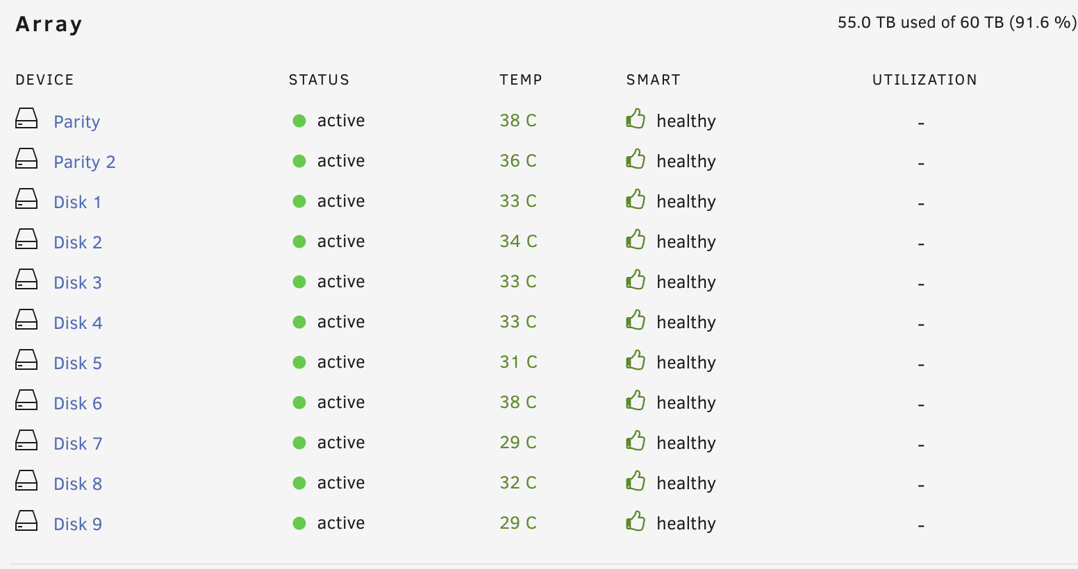

1 hour ago, trurl said:
All disks still mounted and none disabled?
Correct.
Any disks with SMART warnings on the Dashboard page?
None, but the array has been in maintenance mode for the last couple of days as I've been nervous about messing anything else up before seeking advice.
964157076_Screenshot2021-04-22at16_31_48.thumb.png.afc97adb963703f3be1cee84ad5ad6ff.png
