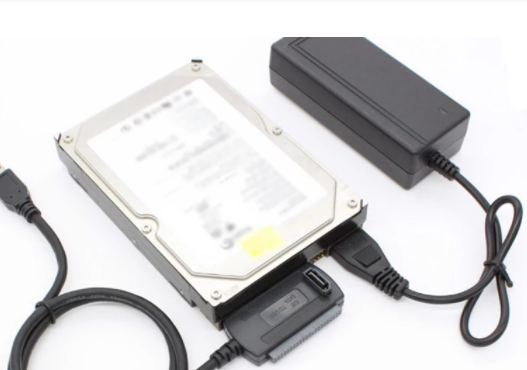

There is a SATA connector but for 2.5". Any idea if I can get this working somehow? I can take drive out from USB enclosure but any chance I can find some kind of cable that would connect full size SATA 3.5" to 2.5" small sata + power from external power supply that was delivered with USB enclosure?
You'd need to pass the SATA cable to the outside and use a 12V power supply for the disk, but it could work.
So SATA cable - I am able to pass it out as already got hole in enclosure done by previous owner.
Now I need to find converter from 12V DC to SATA 3.5 power connector. Kind of tricky :)
If you can't find one on its own these kind of USB adapters come with one:
Plug is molex but it also comes with a molex to SATA adapter.
Yep, found same on at aliexpress. Bought it, will see. Looks like this is the way.
