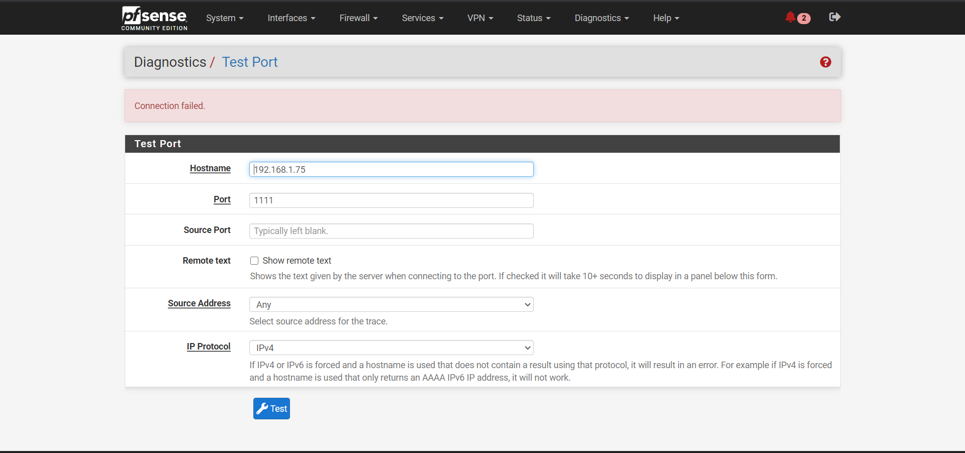

i have a pfsense router and i keep allowing the port in the nat portforwarding but when i check it or use the https://192.168.1.1/diag_testport.php
to test the port it gives a error.
i will change the port after i fix the issue

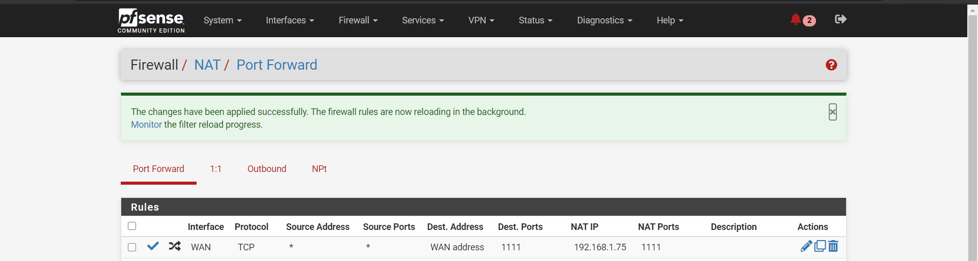

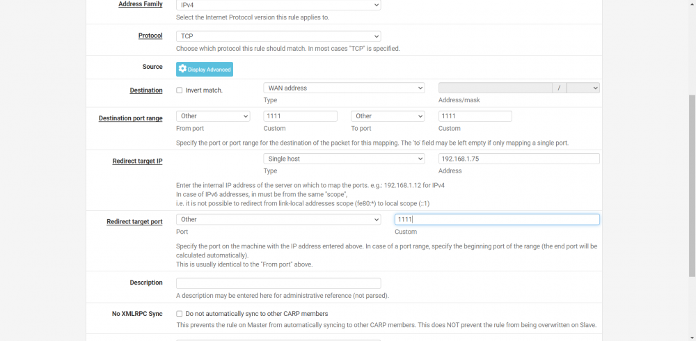

It looks like you are forwarding:
  port 1111/TCP to 192.168.1.75:1111

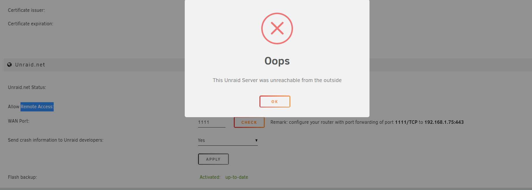

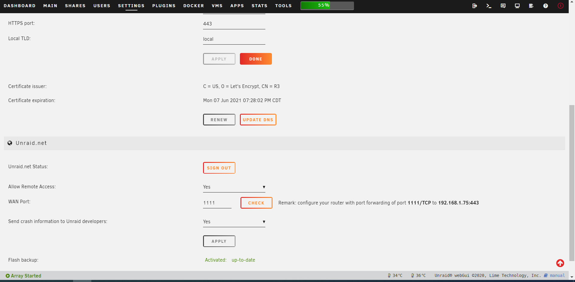

Per the Remark on the Unraid.net settings page you need to forward:
  port 1111/TCP to 192.168.1.75:443
This is because your webgui is running on port 443 internally, not port 1111

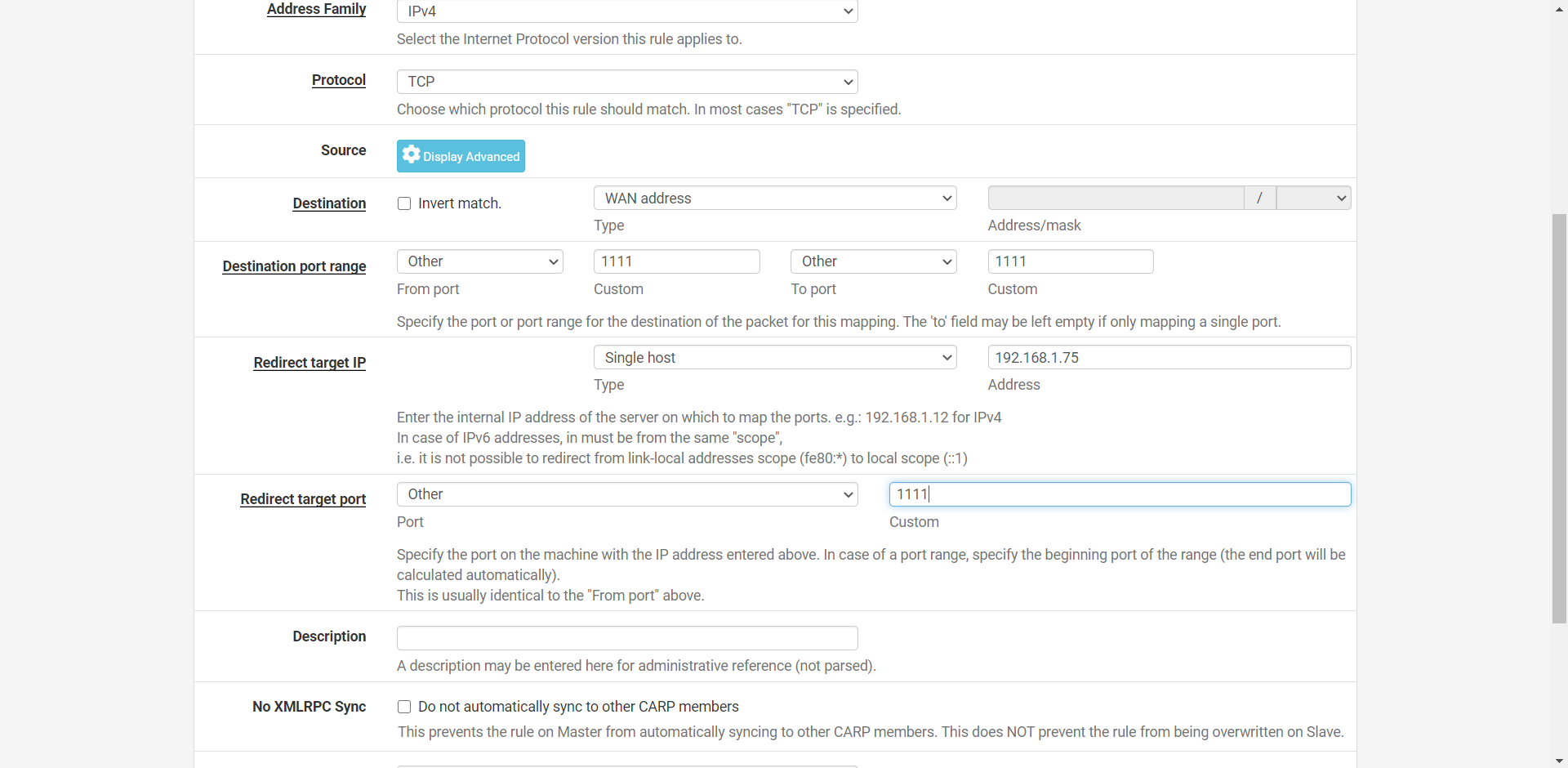

i change it to 443 and i get the same error i then tried changing everything to 443 just to test and still
