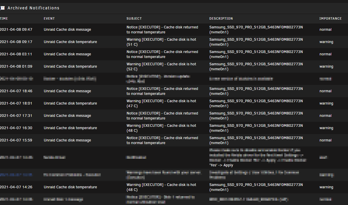

So this is a strange one. I upgraded my server from 6.8.3 to 6.9.1 yesterday without issue. Except since them, my NVME cache drive have been running significantly hotter than usual. I had the warning set at 45C (which is fairly low for a samsung 970) but essentially never got any temp warnings regardless. After the upgrade though, I've been getting a lot of warnings and its frequently sitting above 50C for extended periods. While this is still well within safe operating temps, I'm curious if others have seen this with 6.9.1? I even upped my fan speeds from 30% to 50% and still staying hot. Utilization is at 25%. Thoughts?

This looks OK for an NVME drive.
But I think the user set limits for specific drives were reset in the update.
Maybe you had made adjustments before and need to do them again in 6.9 ?

Hmmmm, could be I suppose. Thanks for the thought!
