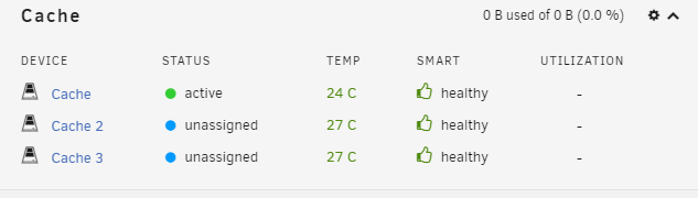

@JorgeB - you are the man. The only thing that seems to still need attention is my cache pool.
According to that there are two missing pool devices.
Not sure why. They are all in the system. I bet I dorked something up when adding them back; just not sure what.

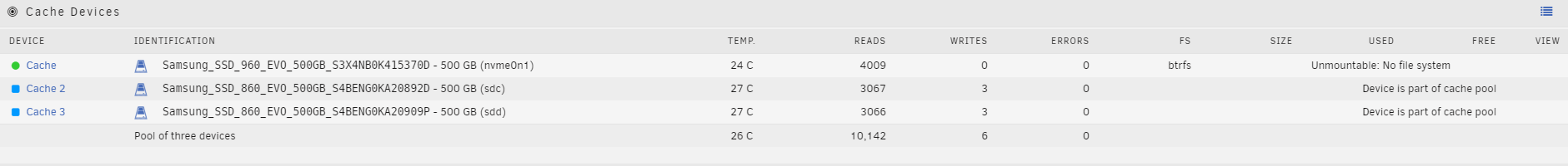

They should have a blue icon, try this:
Unassign all cache devices, start array to make Unraid "forget" current cache config, stop array, reassign all cache devices (there can't be an "All existing data on this device will be OVERWRITTEN when array is Started" warning for any cache device), start array.

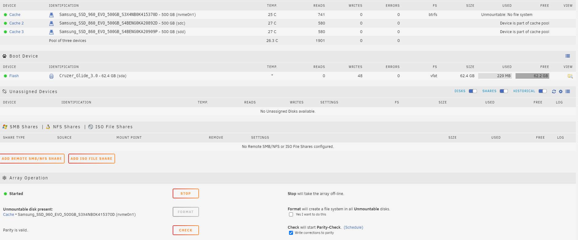

OK. Did the following.
1. Stopped the Array.
2. Unassigned all the cache drives. It wouldn't let me start the array though.
3. Reassigned the cache drives. Started up the array.

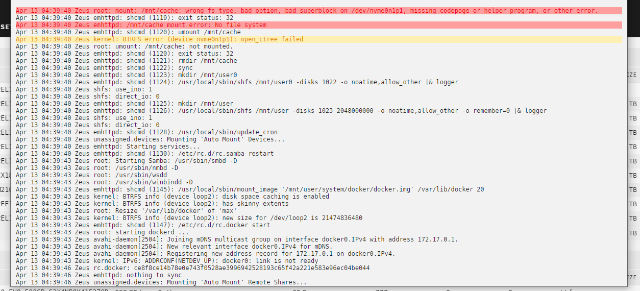

4. Now we have GREEN BUBBLES next to each cache drive but still have the "Unmountable: No File System" on the NVME drive.
Grab current diags, reboot, grab new diags and post both here.

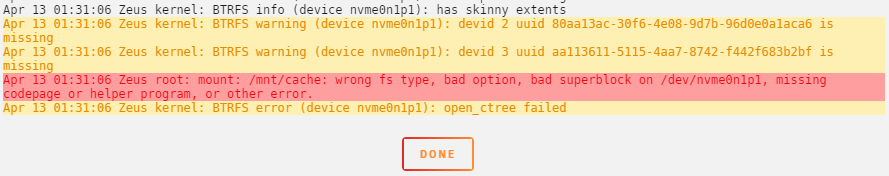

When you started the array before the first screenshot, i.e., when both additional cache devices had a blue icon they were wiped:
Apr 13 01:31:05 Zeus emhttpd: shcmd (453): /sbin/wipefs -a /dev/sdc1
Apr 13 01:31:05 Zeus root: /dev/sdc1: 8 bytes were erased at offset 0x00010040 (btrfs): 5f 42 48 52 66 53 5f 4d
Apr 13 01:31:05 Zeus emhttpd: shcmd (454): /sbin/wipefs -a /dev/sdd1
Apr 13 01:31:06 Zeus root: /dev/sdd1: 8 bytes were erased at offset 0x00010040 (btrfs): 5f 42 48 52 66 53 5f 4d
Apr 13 01:31:06 Zeus emhttpd: cache uuid: 9ac8c9e6-3103-4734-a27f-a043b30a7659
There should have been an "all data on this device will be deleted at array start" warning in red in front of both, now you can try this, with some luck it might work.
With the array stopped type on the console:
btrfs-select-super -s 1 /dev/sdc1
then
btrfs-select-super -s 1 /dev/sdd1
Now start the array.
