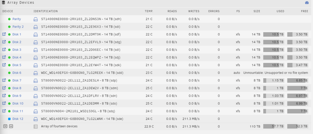

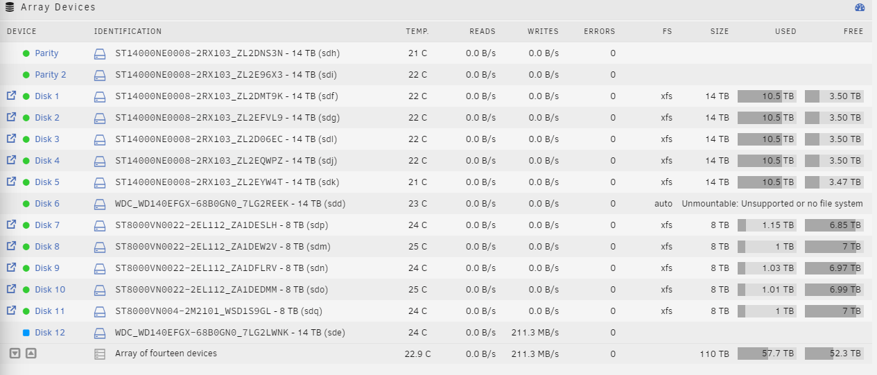

  1. When you say "Mounts with UD" what do you mean? The old drive was XFS - but iirc when I created the array it just did all of that automatically. When I put the new drive in, I added it in slot 6 in the array, and started it up. Did I do this wrong? Should I have formatted it as XFS first and then added it to the array?
  2. Interesting, when the new addition finished it also gave the same issue. Running the command above gave: Phase 1 - find and verify superblock... bad primary superblock - bad magic number !!! attempting to find secondary superblock... Then the scondary superblock just ran with ..... afterwards.

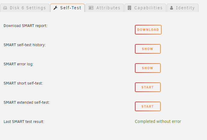

  3. Issue: Drive 6 is showing Unmountable disk present: Unsupported or no file system. Background: Moved my UNRAID server built on a 45 drives Storinator from Japan to the US. Plugged all the drives back in and booted it up, Drive 6 showed failed. Shut the system down, pulled the old drive, and put in a new Western Digital 14TB. Added it to the array as Drive 6 and UNRAID did the rebuild on it as expected. Took just about a day. Came back after work last night and now it shows the error stated above. Did a SMART check on drive 6 and it passed with no issues. Unsure what to do next. Disk 12 is an expansion drive that's in the process of being cleared and added to the array. I didn't realize Drive 6 had the error when I started the expansion! Diags: hades-diagnostics-20230630-1300.zip Any thoughts would be appreciated!

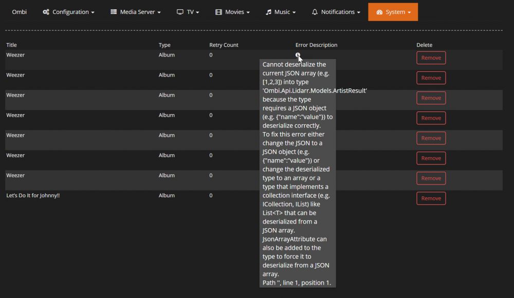

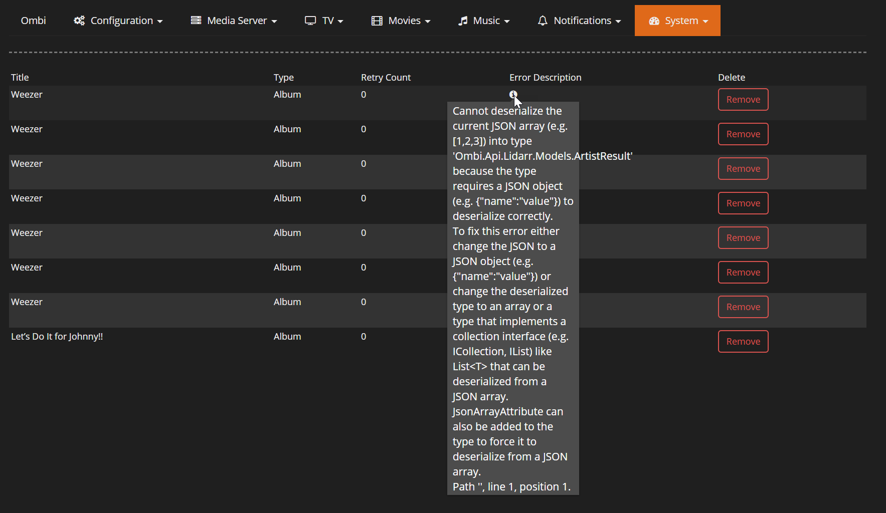

  4. Ombi with Lidarr doesn't appear to be working. I can't search for music with Ombi without it flagging and error. Here's what the log says. Any thoughts? [41m[30mfail[39m[22m[49m: Ombi.Api.Api[1000] StatusCode: BadRequest, Reason: Bad Request, RequestUri: http://10.0.0.161:8686/api/v1/artist [41m[30mfail[39m[22m[49m: Ombi.Core.Senders.MusicSender[0] Exception thrown when sending a music to DVR app, added to the request queue Newtonsoft.Json.JsonSerializationException: Cannot deserialize the current JSON array (e.g. [1,2,3]) into type 'Ombi.Api.Lidarr.Models.ArtistResult' because the type requires a JSON object (e.g. {"name":"value"}) to deserialize correctly. To fix this error either change the JSON to a JSON object (e.g. {"name":"value"}) or change the deserialized type to an array or a type that implements a collection interface (e.g. ICollection, IList) like List<T> that can be deserialized from a JSON array. JsonArrayAttribute can also be added to the type to force it to deserialize from a JSON array.

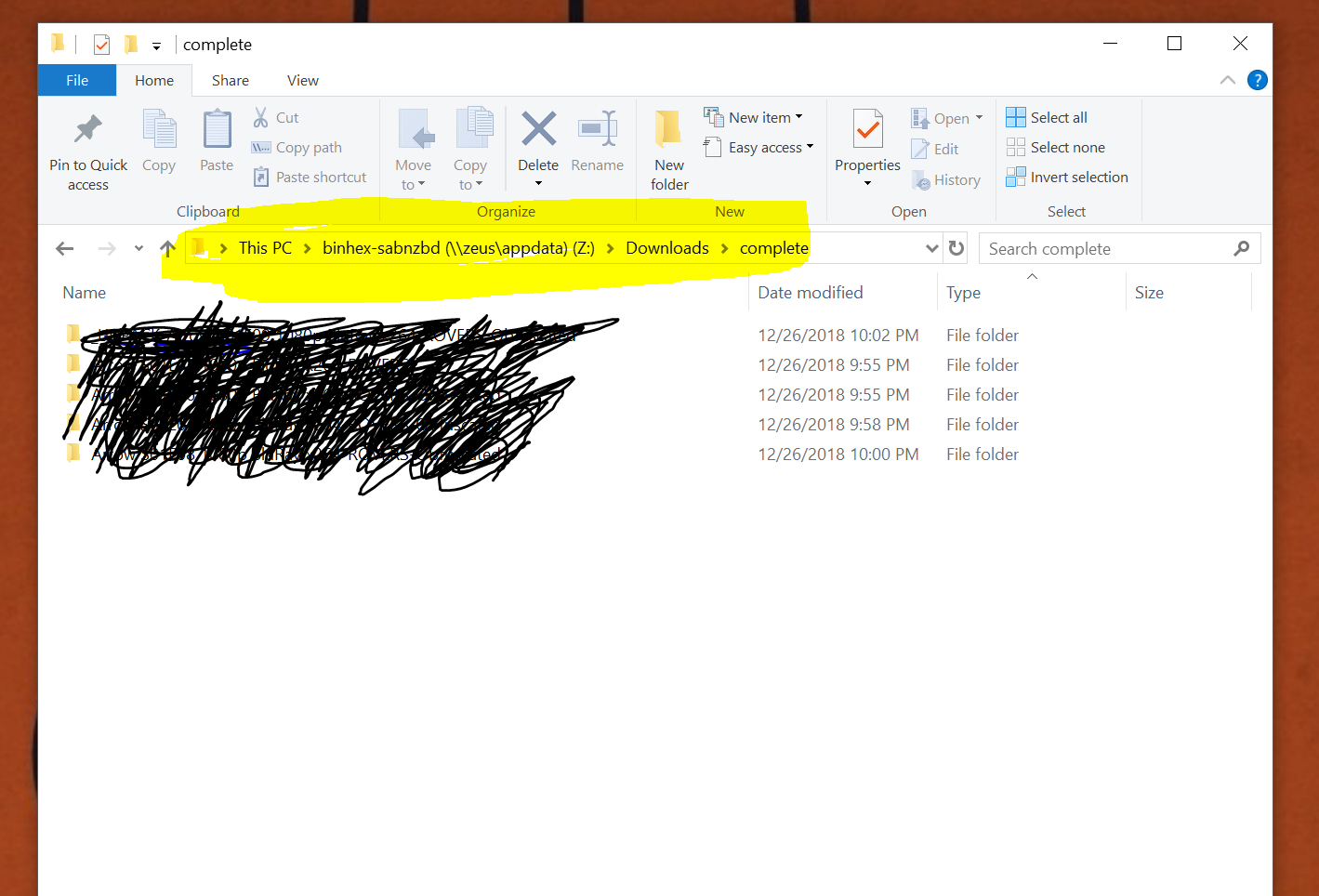

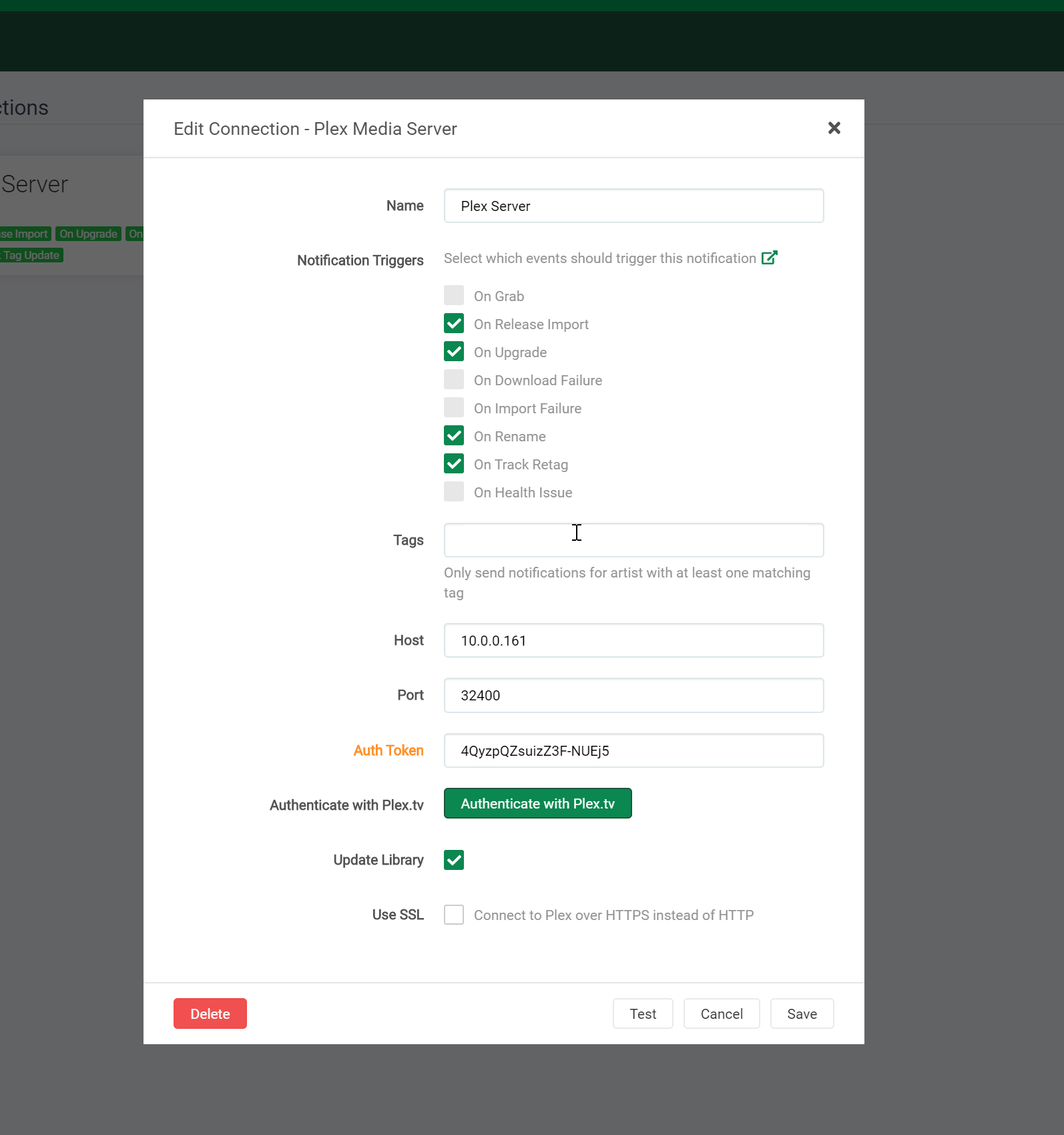

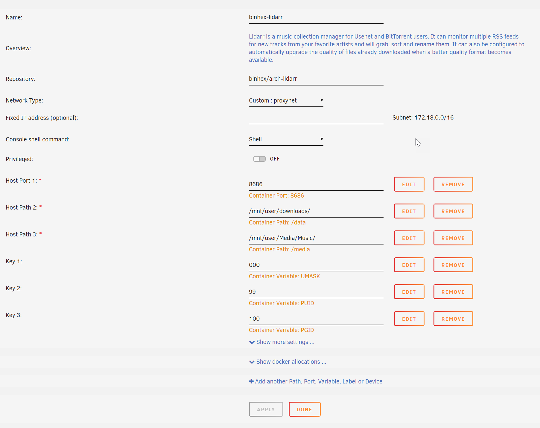

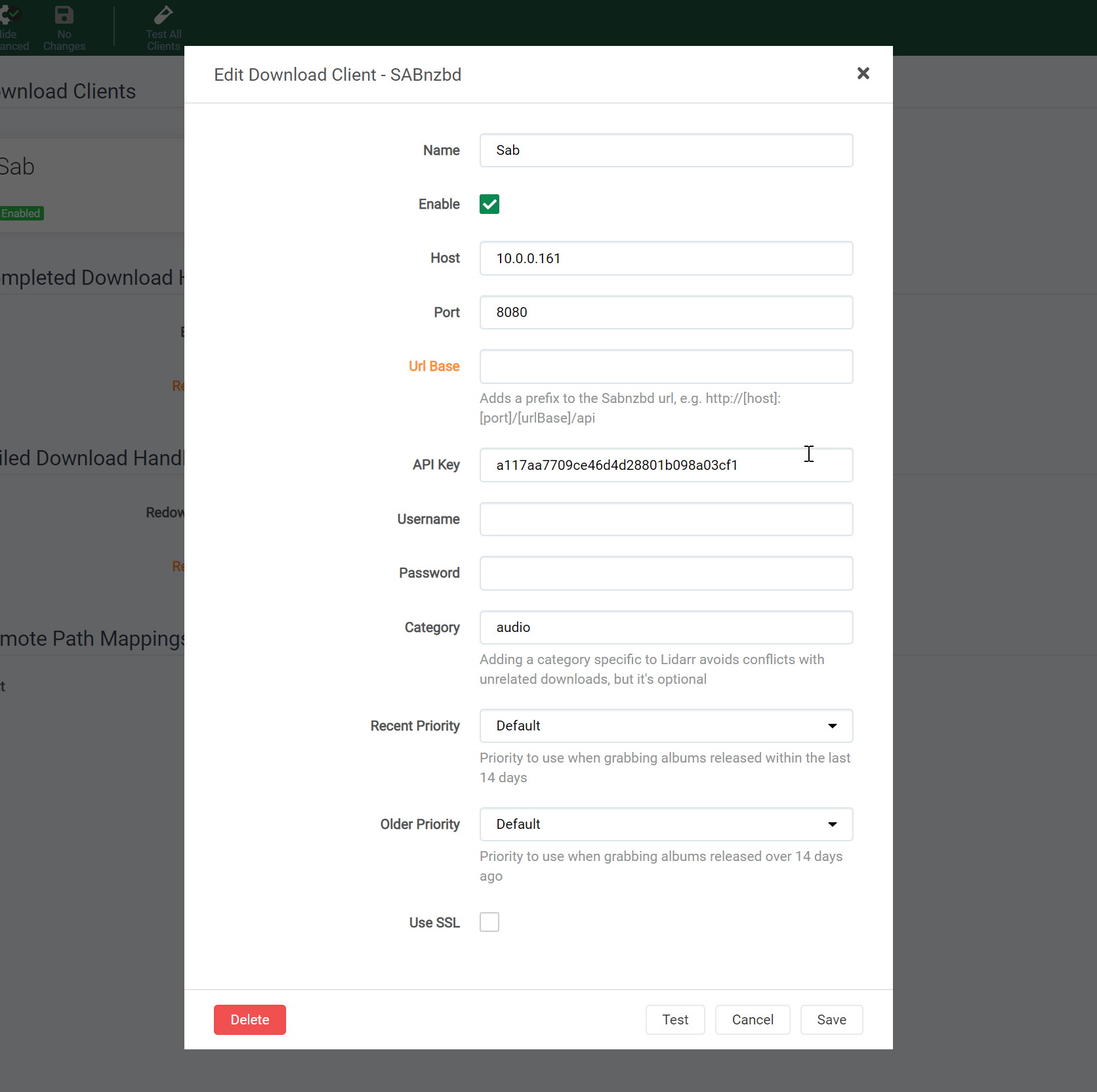

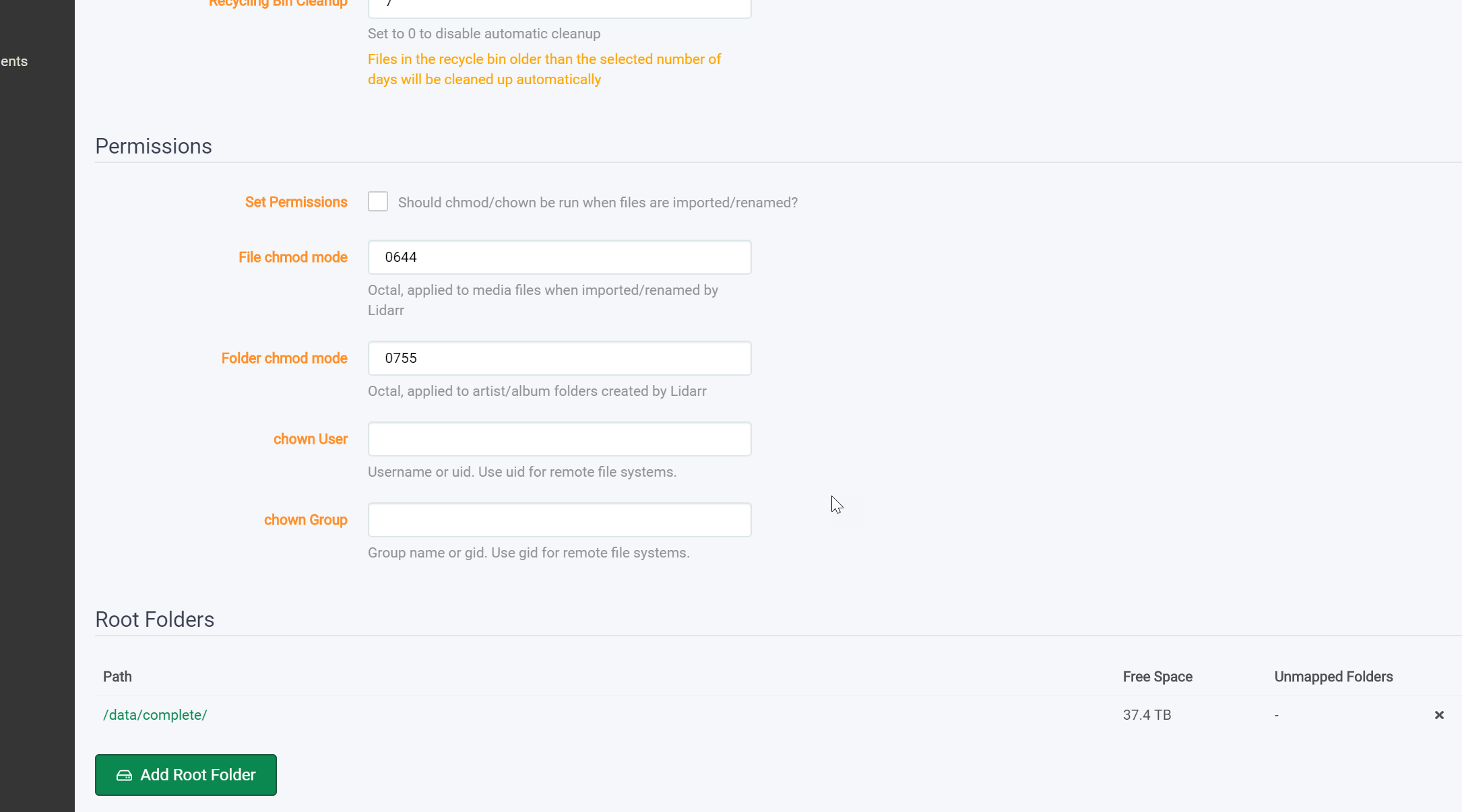

  5. Cheers... I am probably not the first to deal with this so I apologize if there is a simple fix buried in these threads. I have LIDARR setup and it's downloading files fine from within Lidarr, however, there are a couple of issues I can't figure out. 1. When using OMBI to request music I get the following error (first image). 2. When files do download from SabNZB they stay in the "completed" folder instead of getting moved automatically to my media\music folder. I can't figure this part out. Here's some screen grabs maybe a smarter person than I can see what the issue is. Sab Connections: Plex Connection: Configuration Details for Lidarr (same as my Sonarr and Radarr essentially):

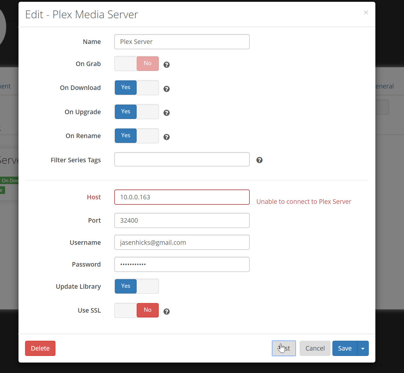

  7. It is and it does. (the media and the auto-populate). I think the link allows the Plex/Sonarr/Radarr setup work to feed off each other? I dont remember what it does honestly, I know I had it setup in the past before I had to "fix" my setup and now it wont test sat between them.

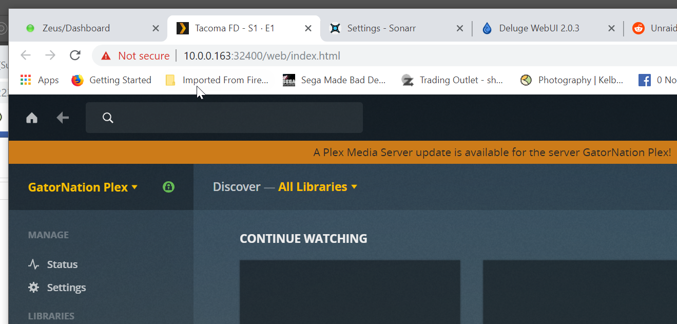

  8. I'm perplexed.... [Start bad joke that will haunt me] I have Sonarr and Radarr setup to grab stuff off the interwebs using SabNZBD. That seems to be working fine. It searches, sends it to Sab, Sab seems to do its thing and for the most part it moves things from the completed folder to the proper location on my media share. I tried to set the link between Sonarr (and Radarr) with Plex [Puncline!] and it gives me the error below. However, I can get to Plex fine through the WebUI, my TV, etc. Any thoughts?

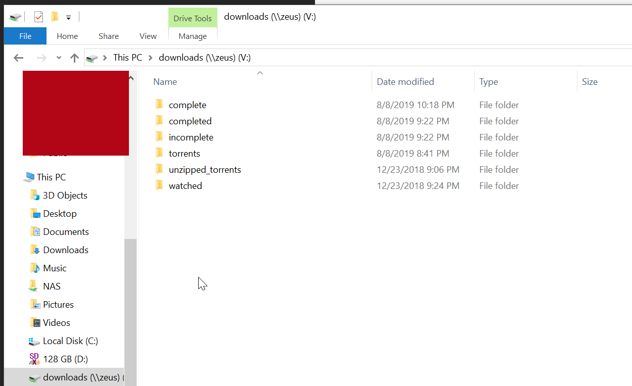

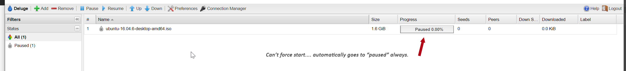

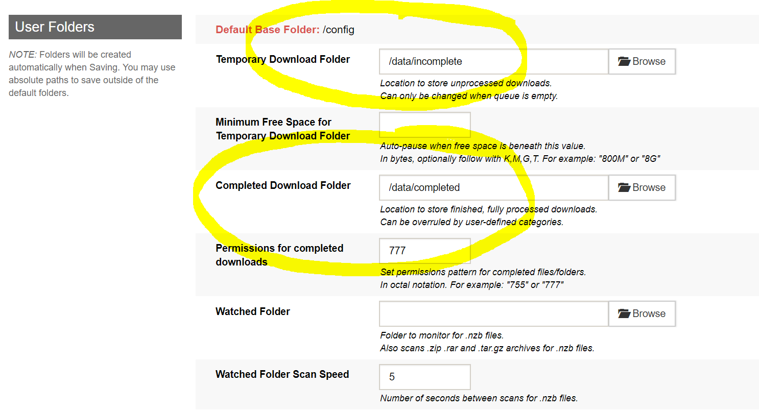

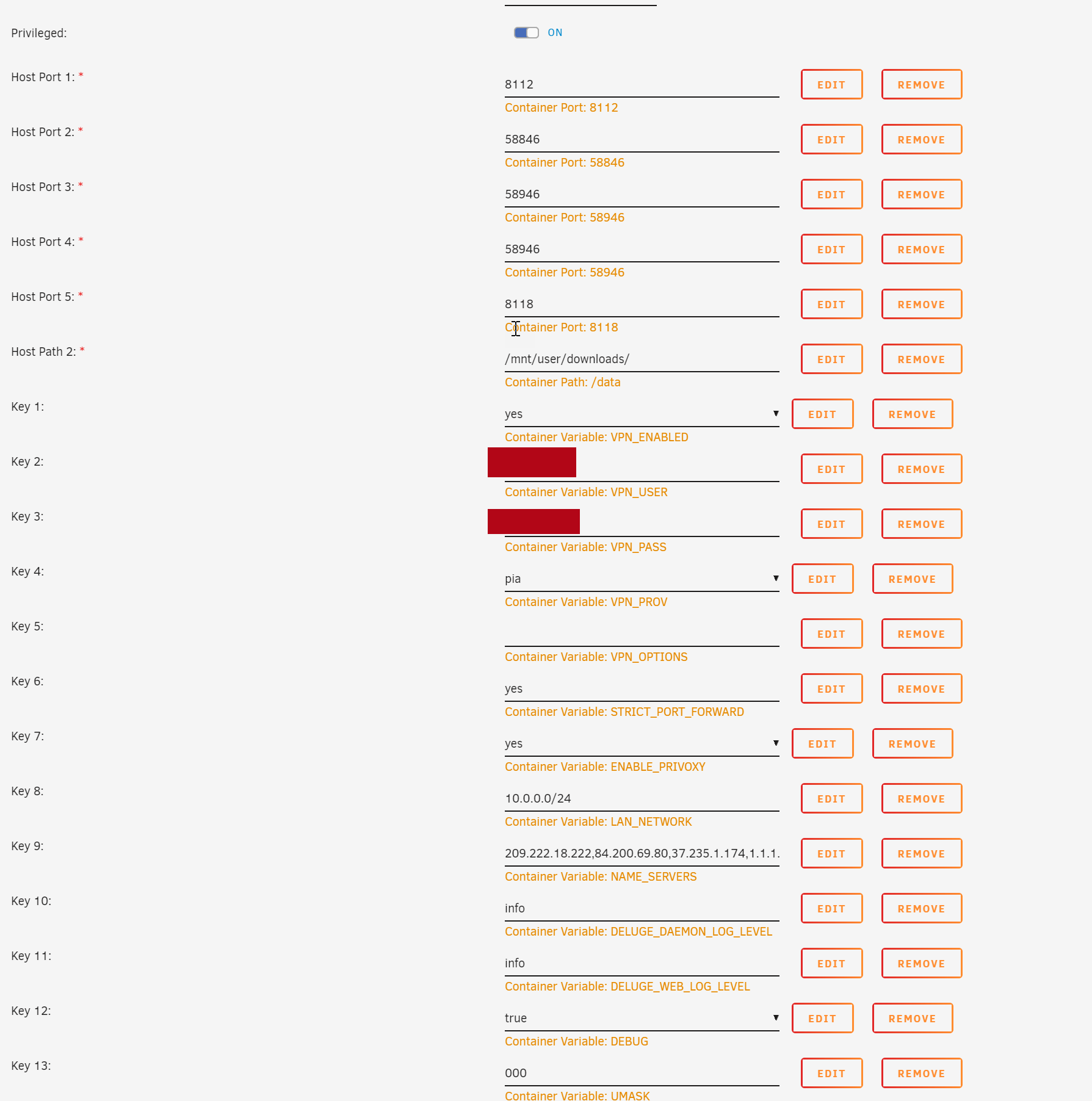

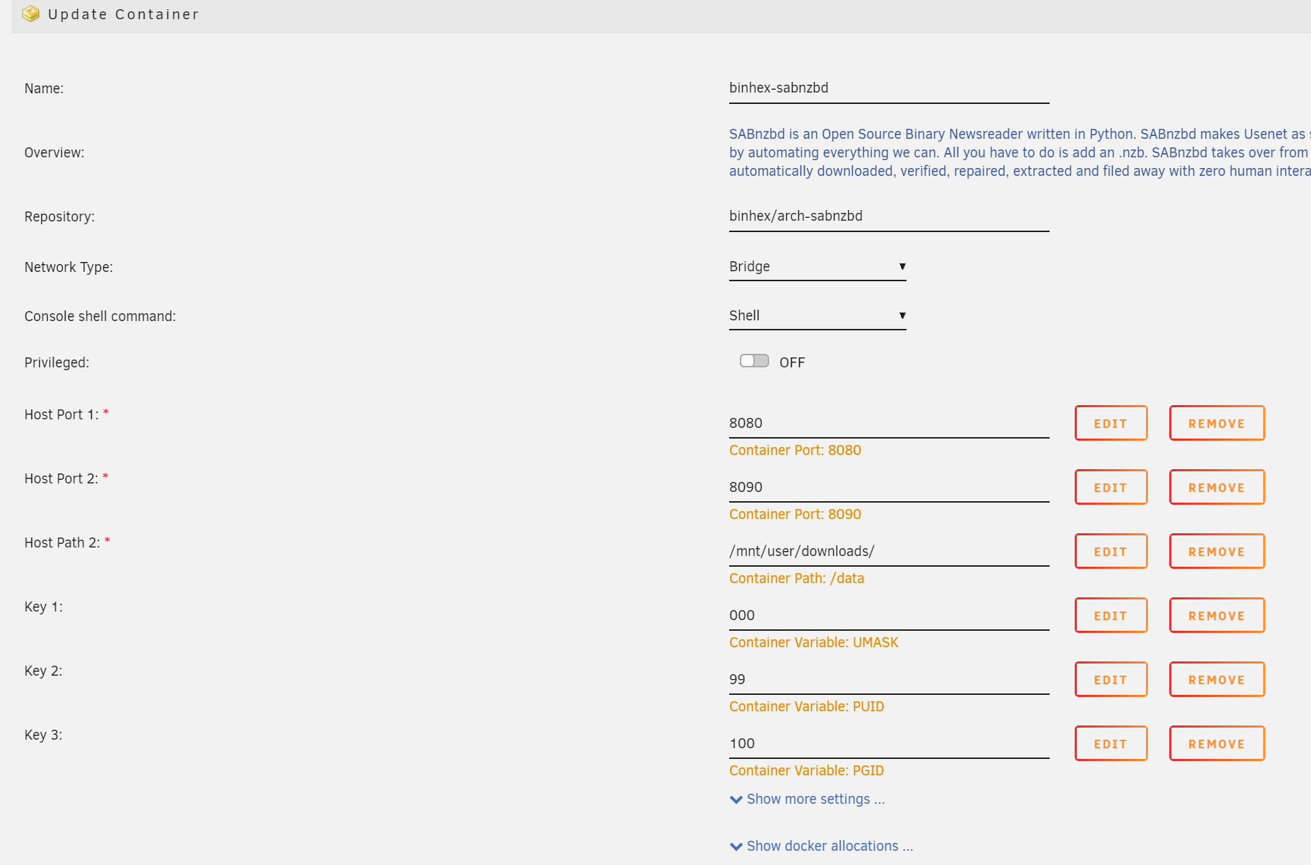

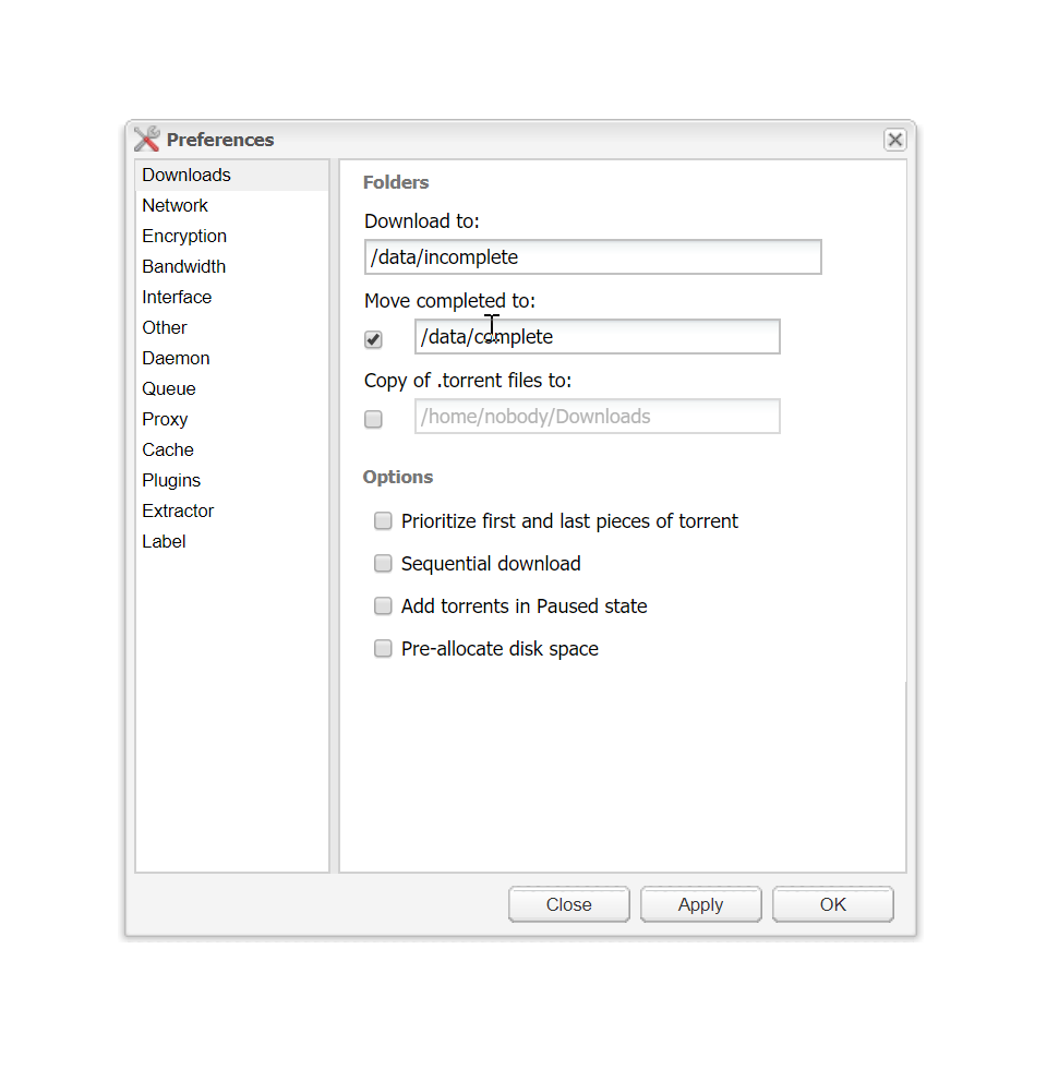

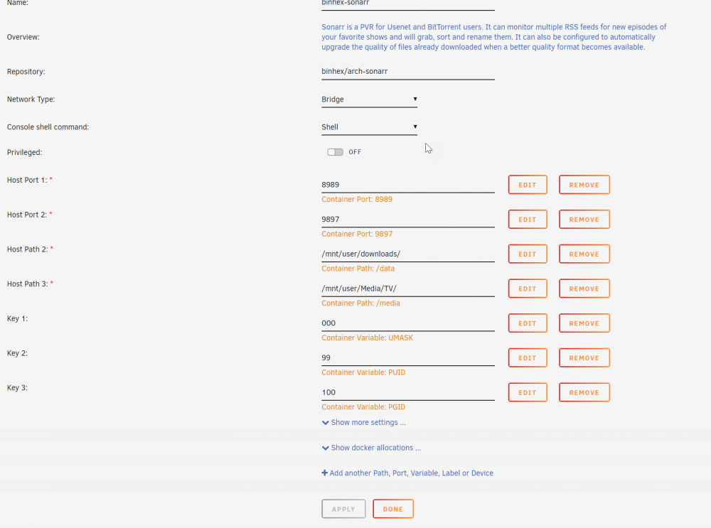

  9. Not sure if this is related to everything else people are recently posting, but I too am having issues with deluge-vpn. Long story short, I had to kill all my dockers/cache drive/appdata and start from scratch. I am setting everything back up fresh (Sabnzbd, Sonarr, Plex, Radar, etc). Got to DelugeVPN and followed the @SpaceInvaderOne tutorial like I did last time, sans using a different end point in Switzerland as it appears the Netherlands no longer supports port forwarding. Fought with it for a while yesterday after intial setup as it wouldn't load the UI with PIA turned on. Messed about today after work, deleted the openVPN files, reuploaded them, restarted and magically Deluge WebUI starts with the PIA VPN turned on. Tried to download ubuntu (worked fine yesterday sans the VPN) and it loads the torrent file but remains at PAUSE. Try to force start it, nothing happens. Attached are pictures showing: 1. Docker Settings. 2. Download Folder "proof" of how I have it setup 3. The Download not starting. 4. Preferences tab of Deluge. Any thoughts would be GREATLY appreciated. supervisord.log

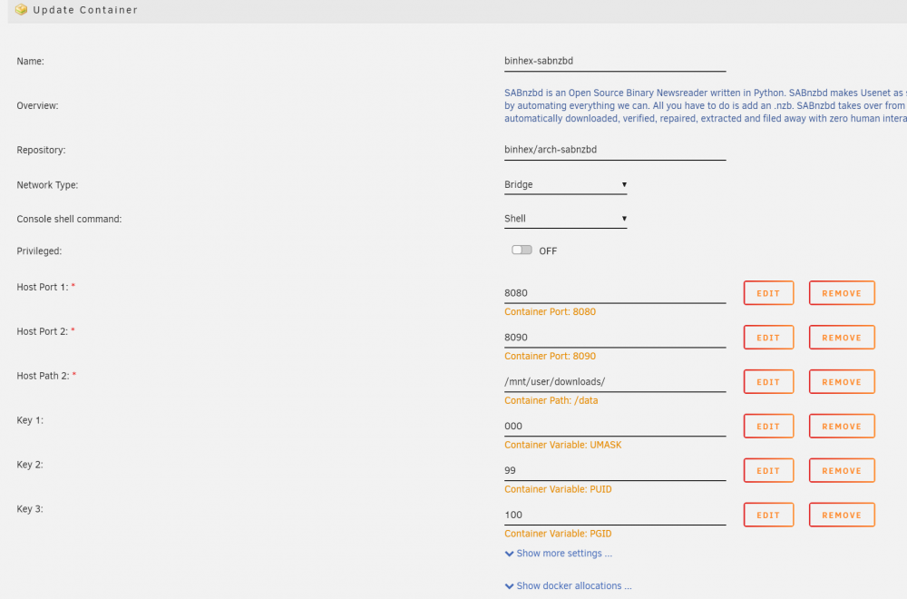

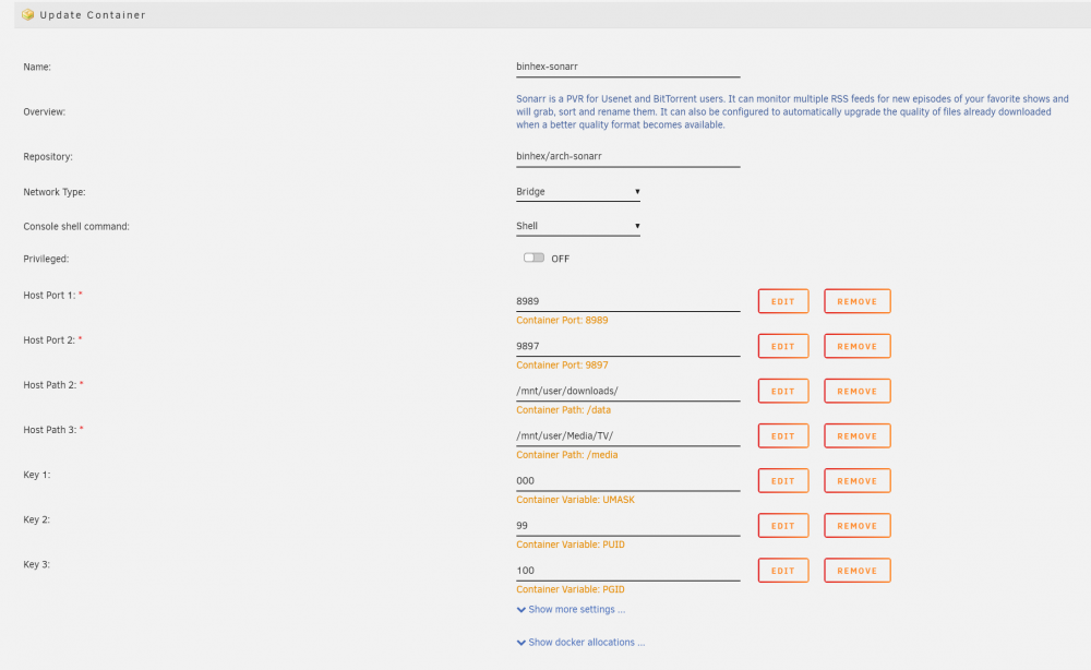

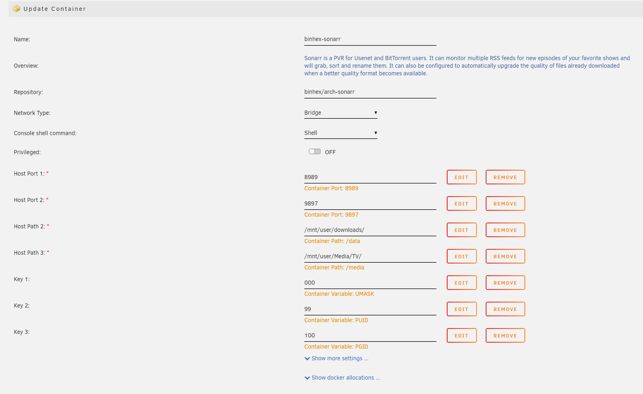

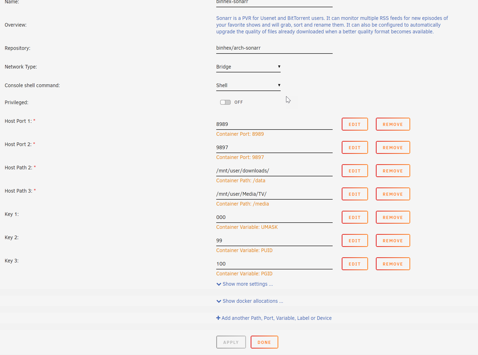

  10. Ok... I found that I had a setting dorked in the SAB setup. I removed all 30 pages of queue and reset the folder locations to be proper (within SAB itself) and now the files are downloading to where I think I want them... more to follow as the story develops. Maybe it will help someone else if this was what it took me to unF* my setup. This is the most frustratingly fun puzzle (unraid and the fun addons) I have done in a while! **** Yes, this fixed it. Woot! ****
  11. I feel like such a noob... I setup Sonarr with Sab/Deluge and Sonarr is sending missing episodes to Sab/Deluge to find them and download. Unfortunately, it looks like (or rather it is) downloading everything to my appdata folder and I can't for the life of me make sense of it. Since its doing, this Sonarr can't fetch the files and move them to the proper place and rename them which is creating A LOT of unnecessary work for me I think. Any suggestions? Error is this: "Import failed, path does not exist or is not accessible by Sonarr: /config/Downloads/complete/FILE.XYZ"

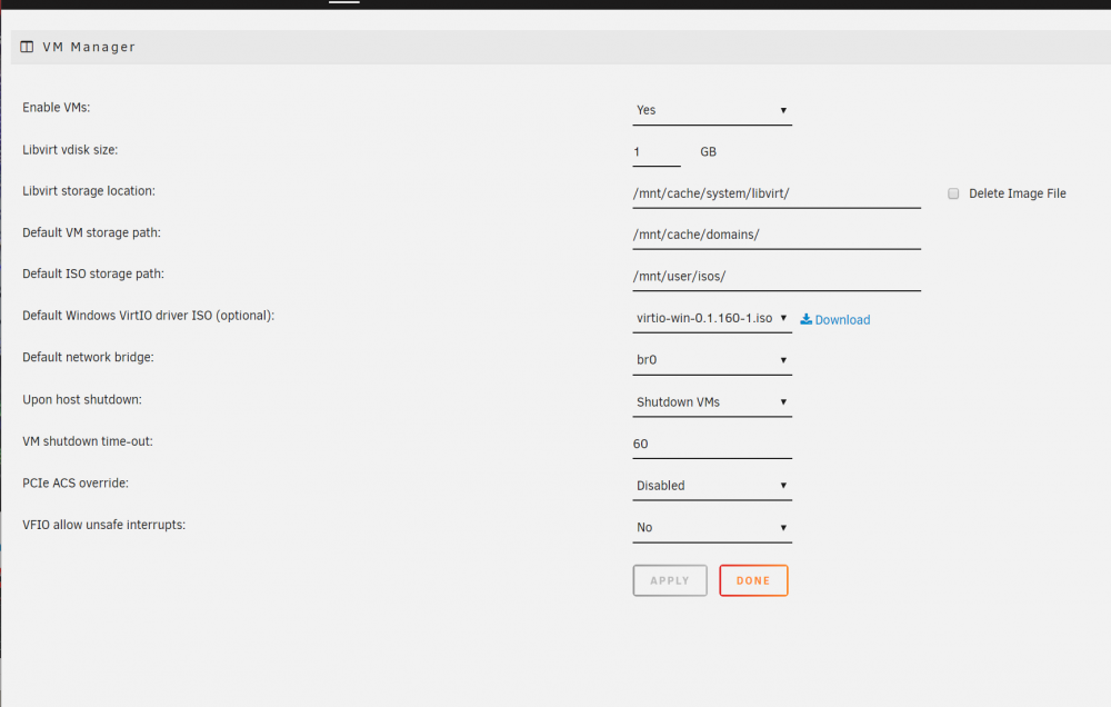

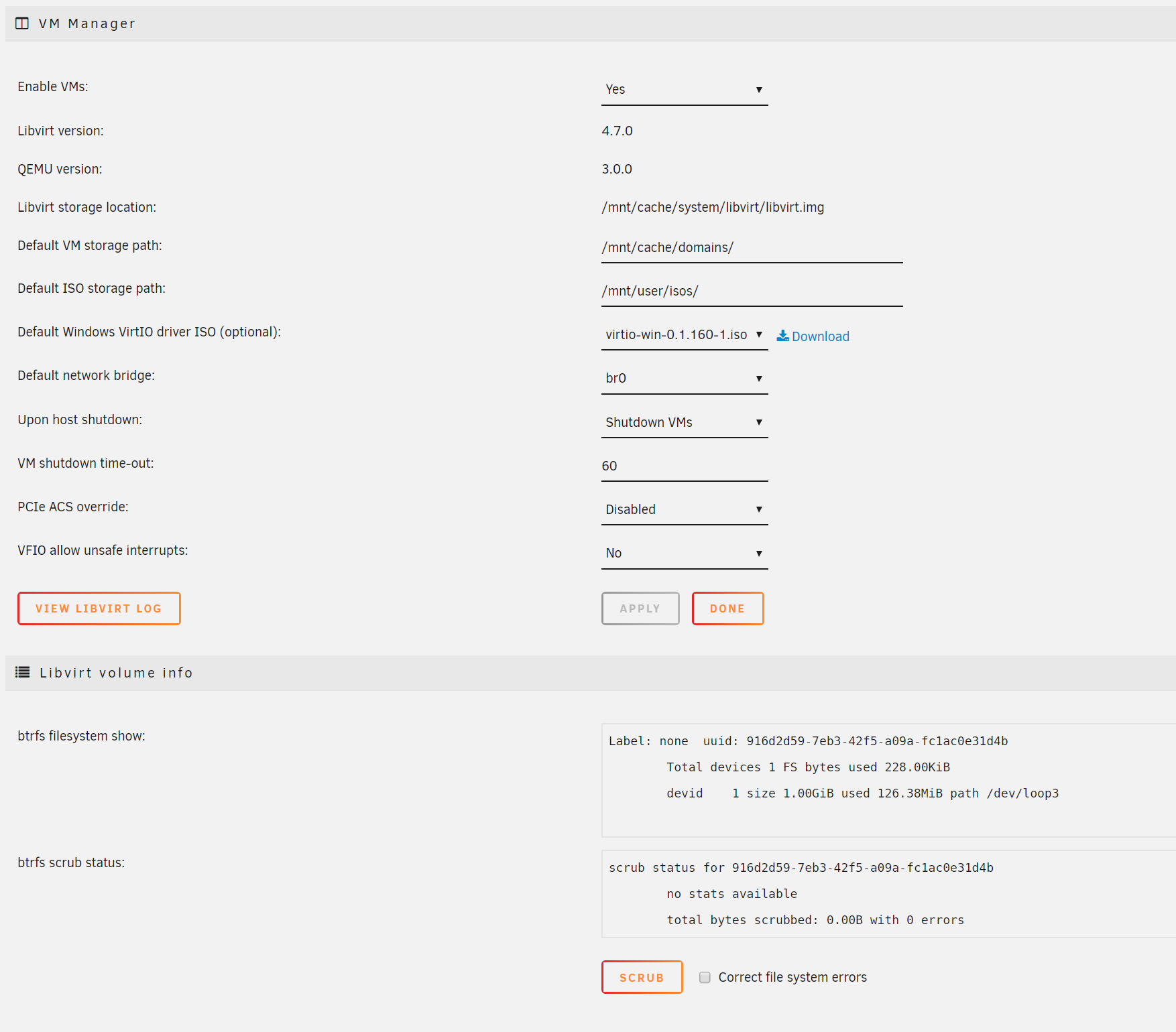

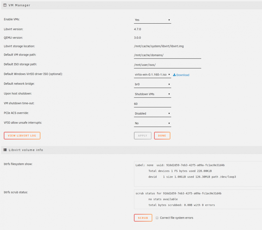

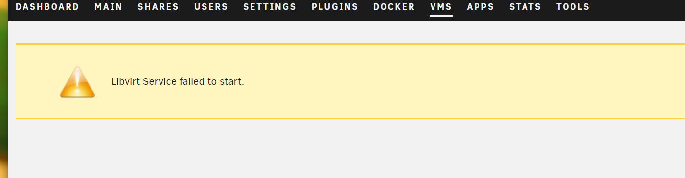

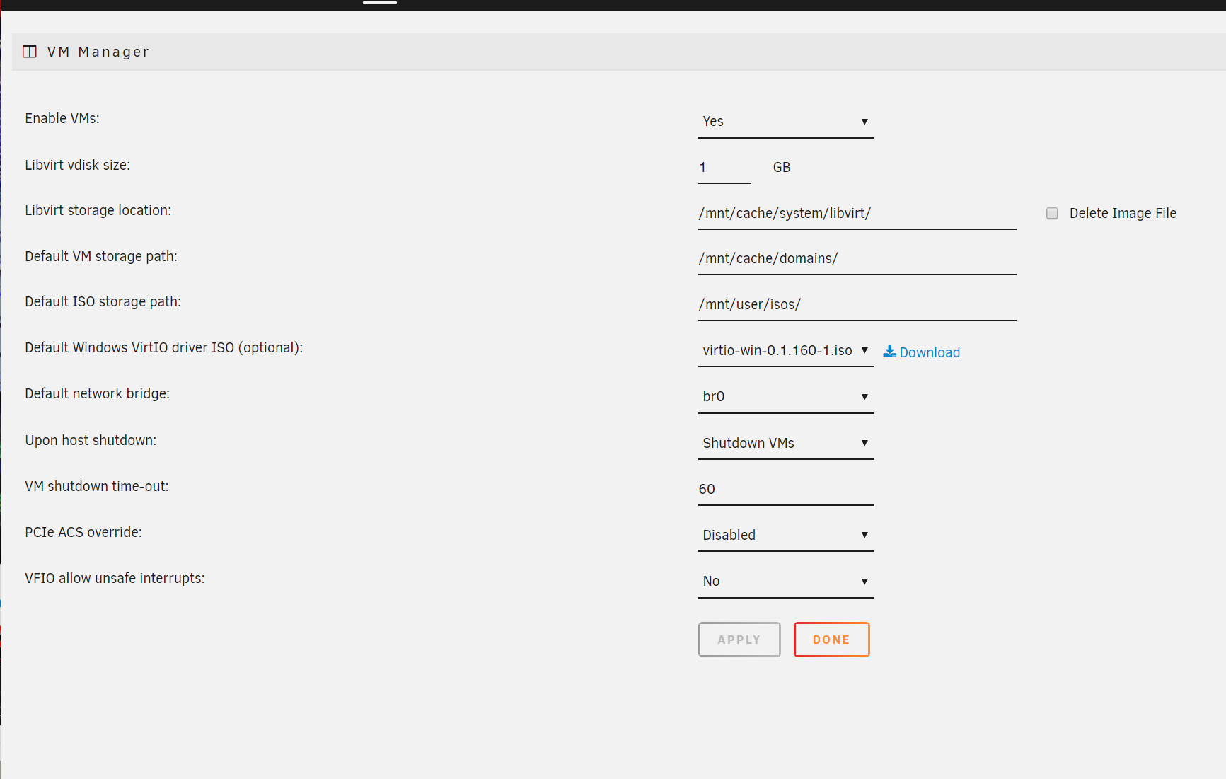

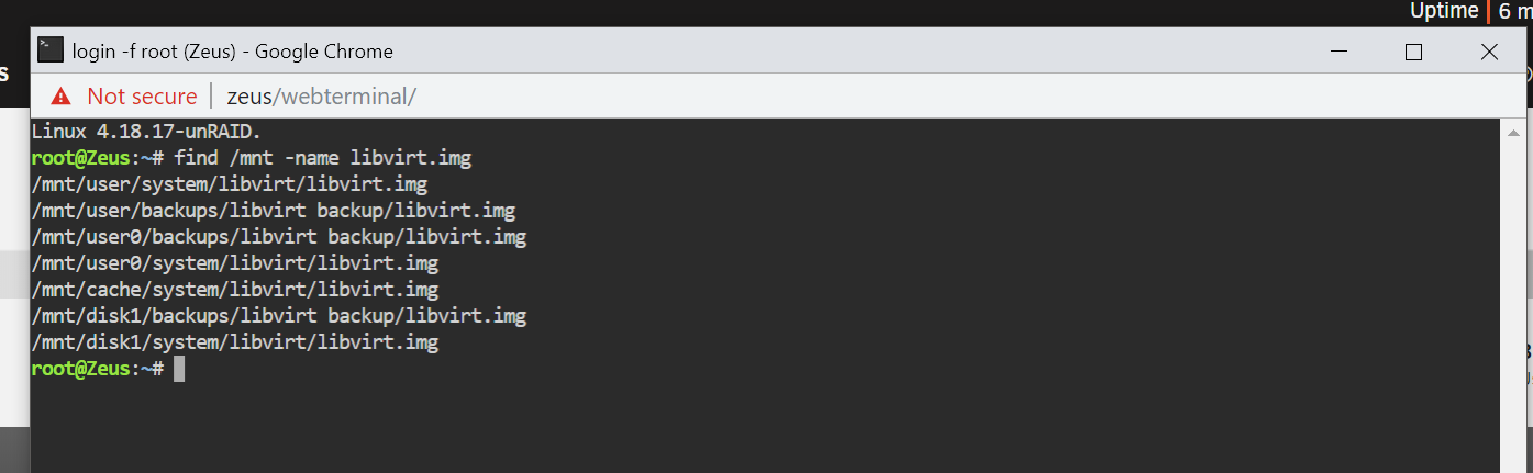

  12. I'm a jackwagon.... turns out you need to have the libvirt.img file in the storage location as well. Thanks for the assist! ::BeerForYou::
  13. Whelp... it did something. Not what I expected though When I did stop it and change the storage location, it did show my Win10 VM.
