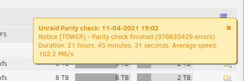

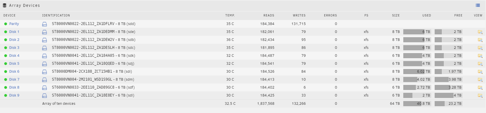

It finally finished this morning and there were A LOT OF ERRORS (screen grab attached). I checked some folders I knew I had files in from the past few days, and those files are not there. I clicked into the folder icons next to each drive in the array and the disks attached to my motherboard SATA controller all show directories/etc, but when I clicked the folder icon next to any of the drives on the new card, they are empty. Additionally, the drives on the card aren't reporting temperatures.
That many errors suggest the controller dropped (or all the disks there dropped, syslog doesn't show what happened), rebooting or fixing the issue should bring all your data back.

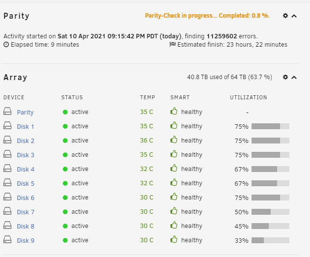

@JorgeB - I think the PCI-E slot on my X399 motherboard failed or something. I spent the last 4 hours migrating my i7700K board, memory and CPU to my UNRAID system, managed to get all drives assigned (except my cache pool), checked parity valid and started the array. It looks like everything is being seen and there is at least data on each of the drives now. I am running the parity check now, I did notice that it found quite a few errors already (perhaps its fixing the replacement drive that's blank).
Looking at the "MAIN page" no errors yet. I think at this point last time there was a ton. We might be on the right track!

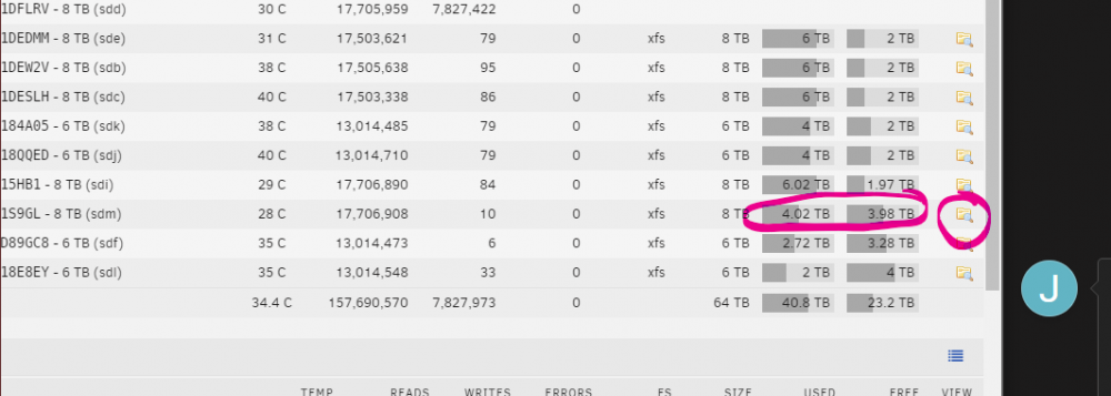

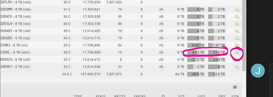

For awareness, when I click the  folder icon for Drive 7 (highlighted in pink) it's empty, but it shows over 4TB used. I suspect, that's where my missing files are.
36 minutes ago, JasenHicks said:
So, what do I do when the Parity check finishes but you are missing files?
That suggests there were errors on another drive(s) during the rebuild, and the sync errors found after the parity check also support that.

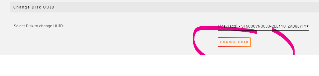

Change that filesystem's UUID (Settings -> Unassigned devices) then you can have the array started together with that disk and compare both disks content, you can for example use rsync.
Click this guy?  Should it "do" anything that I can see?

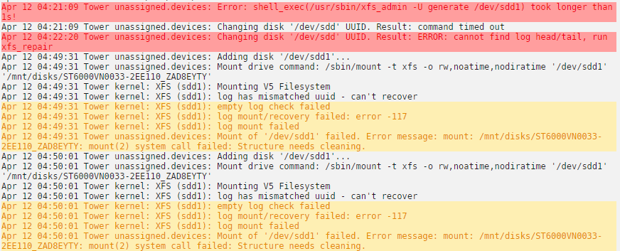

I clicked it.... I saw this in the Syslog
Run xfs_repair first:
xfs_repair -v /dev/sdd1
