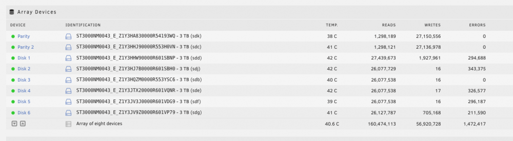

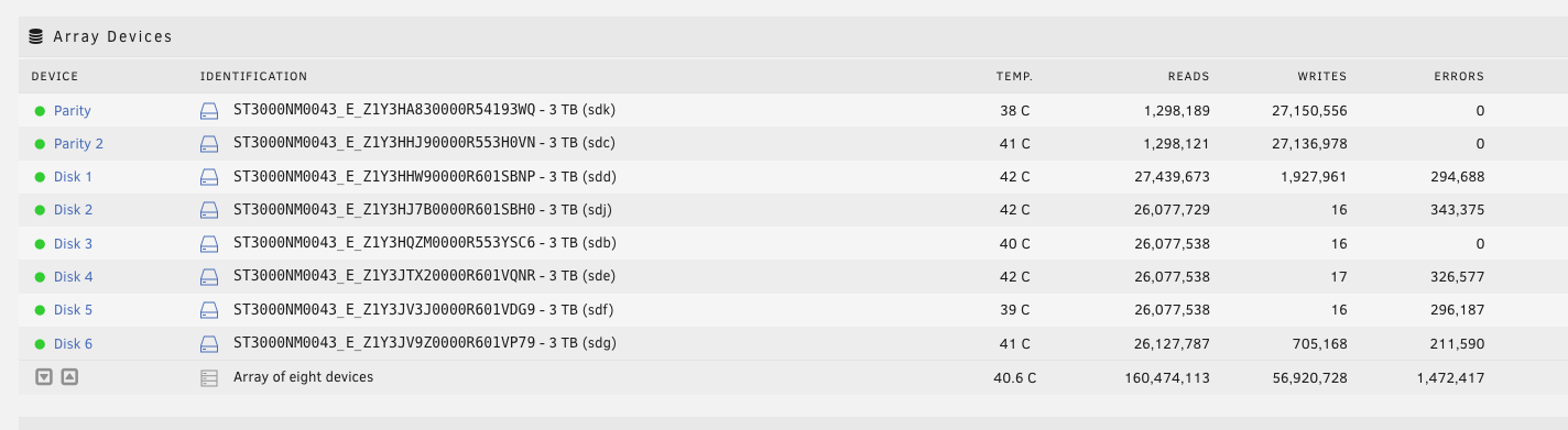

I have built some server for me and am using SAS Seagate drives with LSi controller. Unraid is reporting errors after it does parity build, just in last % of the process. Up to 98% it shows no errors and then gets all in picture in last few %.
Also i have tried rebuilding a few times and sometimes one drive shows these errors and next time it doesnt.
Can someone explain is these errors "bad" or they are just i/o recovered errors and are ok?

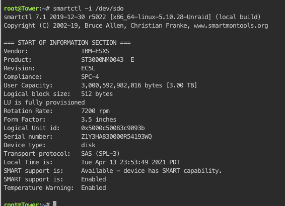

Disks are formatted with type 2 protection, try removing that, you can find out how by googling it.
Stoked for fast answers, thank You Jorge and Simon. Already installed sg3_utils in Nerd Pack under apps and checked all disks, yes type 2 protection. Now put all 8 to format with
sg_format --format --fmtpinfo=0 /dev/sdX
Where X is drive letter
Will take some day to complete
Thanks again!
Edited by Janis
So the drives finished formatting overnight and now the smartctl -i /dev/sdX shows no more Type 2 formatting.

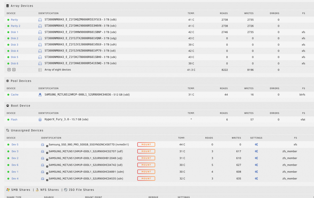

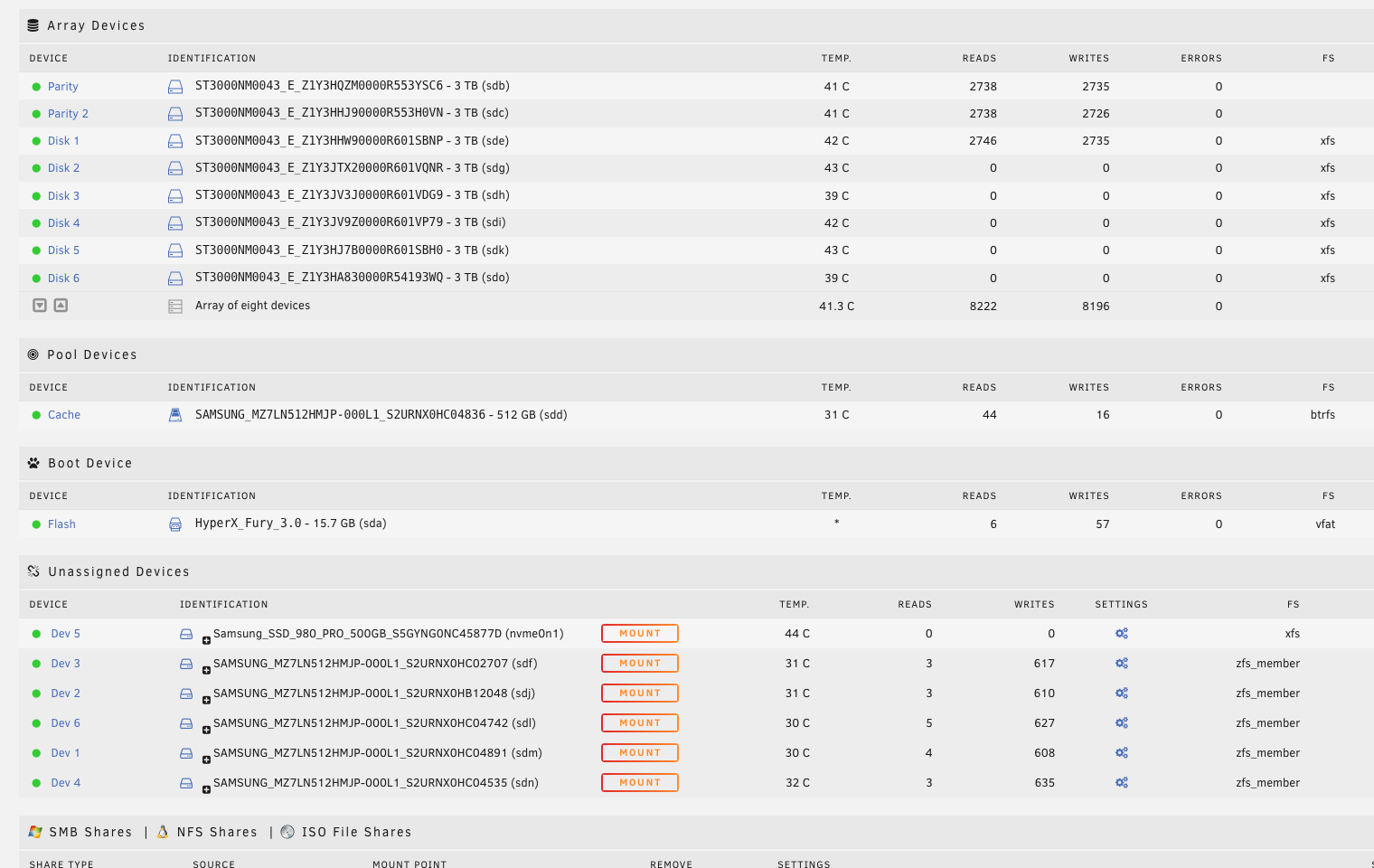

I can report all issues to be gone now. Disks are fixed, no more errors. Whats pretty cool is that also there is speed penalty while disks are Type 2 Formatted. Before it took 8+ hours to do parity build, but now it took 6 hours.
