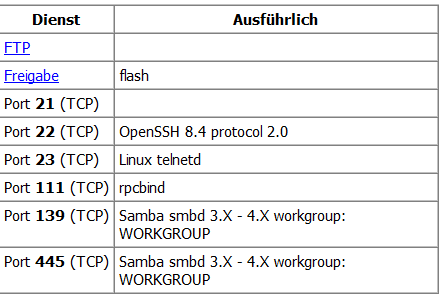

when I use a freshly installed unraid (v 6.9.2) I cannot access to port 80 too
what am I doing wrong?
Either your flash drive is terrible and corrupted or its dropping offline causing the issues.  Try a different USB port (ideally USB2).  If that fails, replace the drive.
