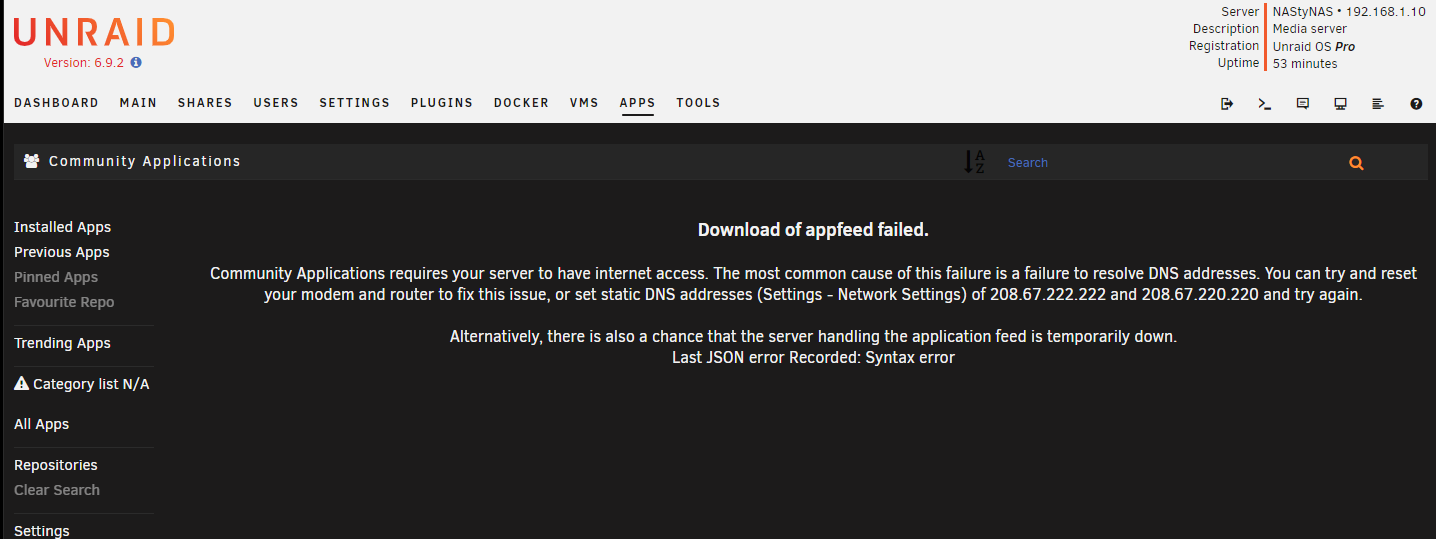

"Download of appfeed failed." - Apps page failing to load information
Unraid is giving me an error every time I attempt to load the Apps page on my Unraid server. My DNS server settings are fine I've tried multiple settings included the recommended ones.
  • I am running version 6.9.2
  • I can get to the server just fine on my network.
  • Other network devices can get to the internet just fine.
  • I attempted to change the NAS IP address from 192.168.1.10 to 192.168.1.12 and the same app store error occurs
I'm not sure what the issue is. Does anyone have any input?

Did you try what the message is suggesting to try?  post your diagnostics
