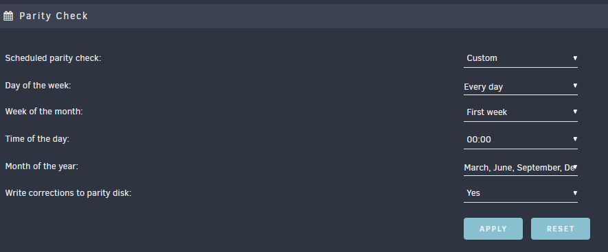

I'm interested in running a parity check every 3 months but cant figure out how to schedule that.  Here are the settings in Unraid
That's the closest I can get.  I select it for March, June, September and December, to start at 00:00 on the first week, but under "day of the week"  There is no "first day" option.  I only see days of the week like "Monday, Tuesday, etc" and those are always changing for the 1st of the month.
With the above settings It seems like it will run it every day during the first week every 3 months (So it will run for 7 days straight).  Am I wrong here and this is just bad wording in the UNRAID GUI or does it actually work like this?

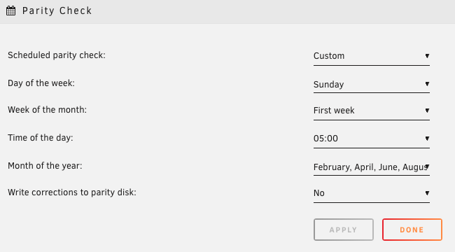

Set a specific day of the week, like this:
It results in this, the first Sunday of every second month:
But I want it to land on the 1st day of the month as thats when my users expect slowness and downtime as I run backups.  I guess the first Sunday will be the best I can do for now.  Maybe a future version of Unraid can add the option for first day
