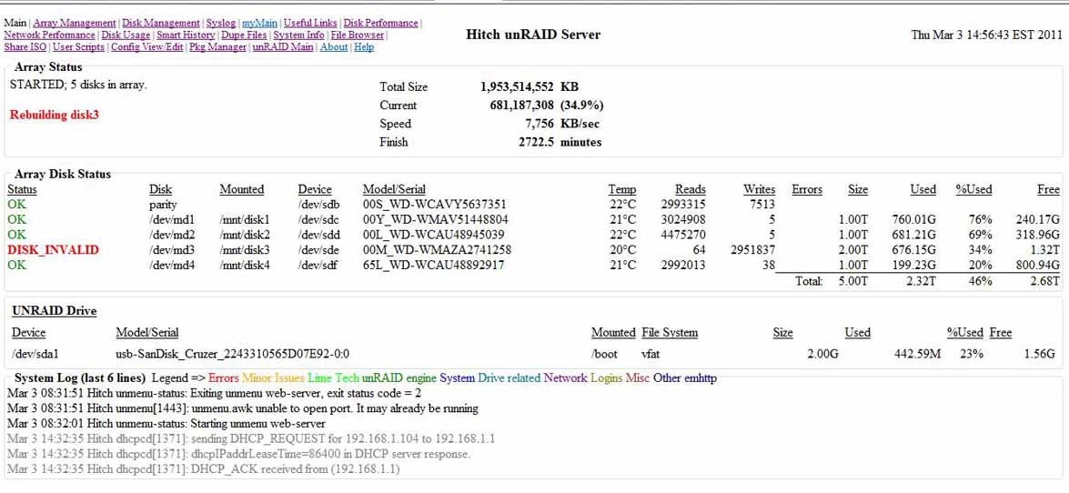

I have attached a screen cap of the unmenu screen in case something stands out.  Thanks.
The rebuild is going very slowly. Please post full system specs.
