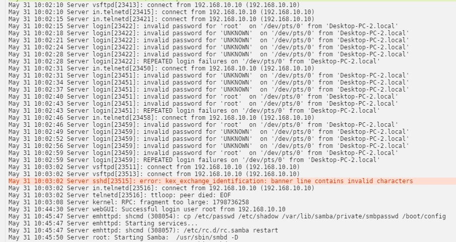

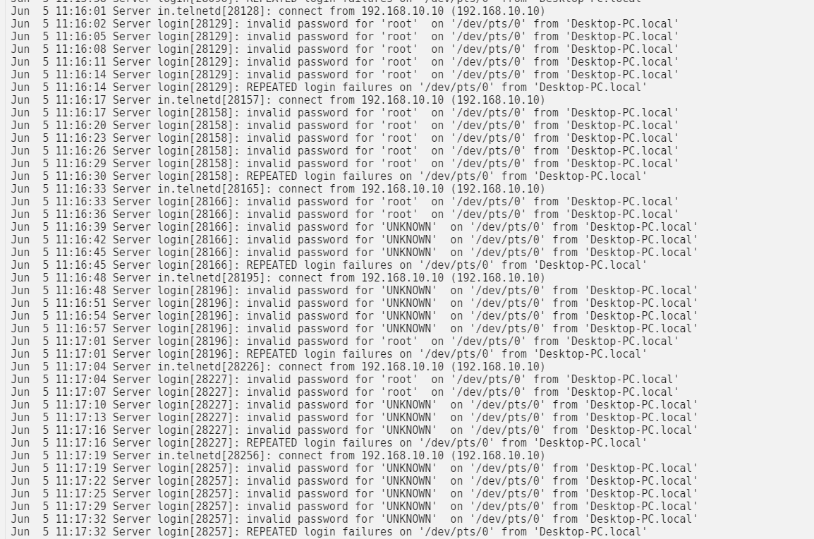

Good morning. I am hoping someone can help me as I am not that technically minded but I have in the last couple of days got email warnings to say possible hack attempts. I am not sure where it is coming from or how or on any port. I have changed password on my router, on Unraid and anything else I can think of. Can anyone point me in the right direction as to what else I need to do or see where this is coming from please. I have attached a few screen shots of the syslog if that helps.
A computer on your local network named Desktop-PC-2?
I do have a laptop and a desktop and the name on the desktop pc is Desktop-PC. it is not called Desktop-PC-2, which i thought was a bit odd.
Also, as I know the password to the server, I would not have got it wrong 17 or 18 times.

see below
Who is 192.168.10.10?
The device logged in some time after the failed attempts

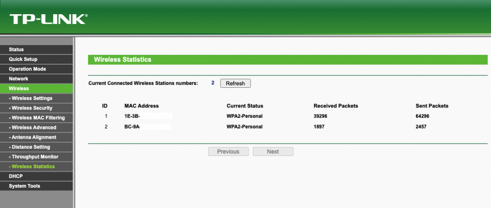

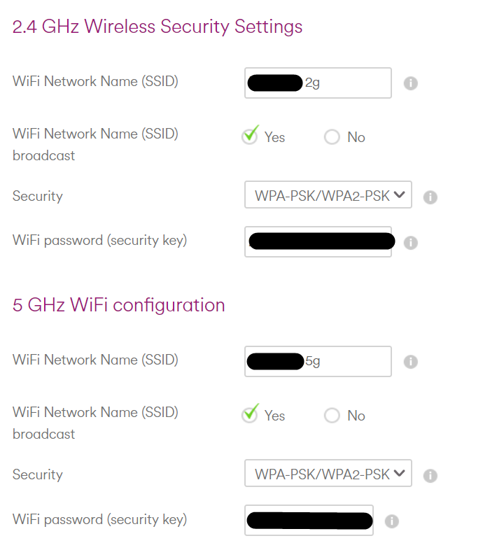

thanks for this. i have a virgin media hub, but not sure in the router page/wifi statistics what i am looking for..
My router wifi is on the same network and below are the current setting. Thanks.
The device logged in as soon after the failed attempts
192.168.10.10 is the main DESKTOP-PC as below, but it has never been called DESKTOP-PC-2

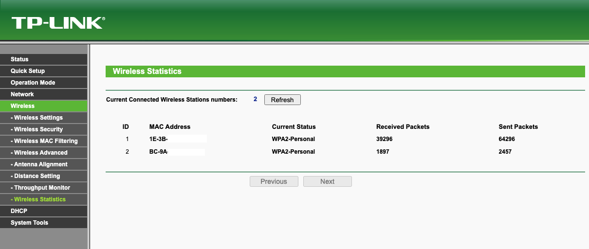

Usually in the statistics page there is a list of mac addresses of connected devices:
Something like this:
From there you can see my wifi receiver has 2 clients connected, who can be identified with their mac address.
You are in the wrong page, that is the security settings of your wifi.

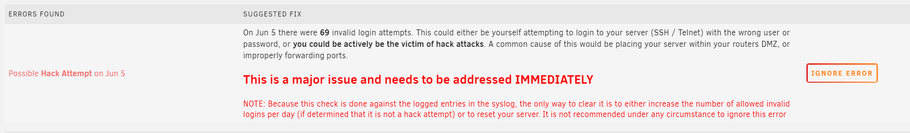

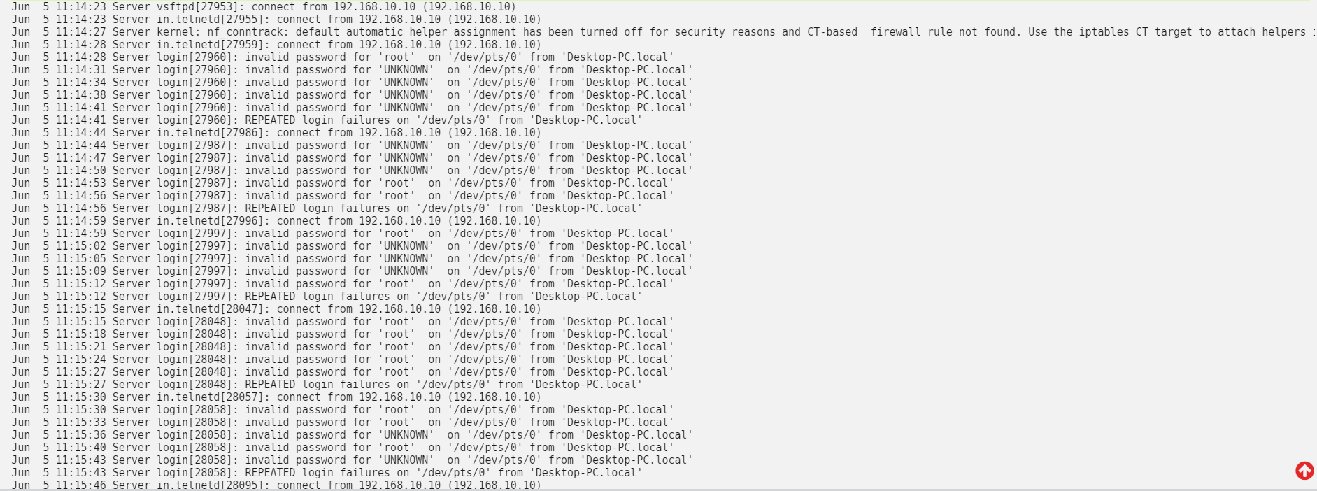

thanks all. However, i changed all passwords, on everything from the router, the root to unraid, all the wifi passwords and got the below alert this morning.
i am at a loss now what to do. i have scanned the desktop=pc with anti virus as welll as malwarebytes and nothing found.
Some antivirus, especially those with "internet smart protection" may cause these alerts.
but why would anti virus be trying to access "root" and "unknown" from my desktop pc? just seems odd. i am currently in the middle of factory setting the desktop pc, then we will see if it keeps happening. Pretty drastic i know, but i have back up of any documents.
Example of a device on the network "helpfully?" trying to hack into other devices.
