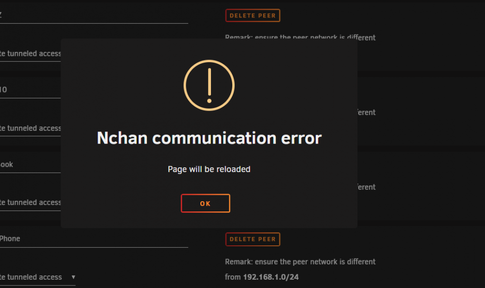

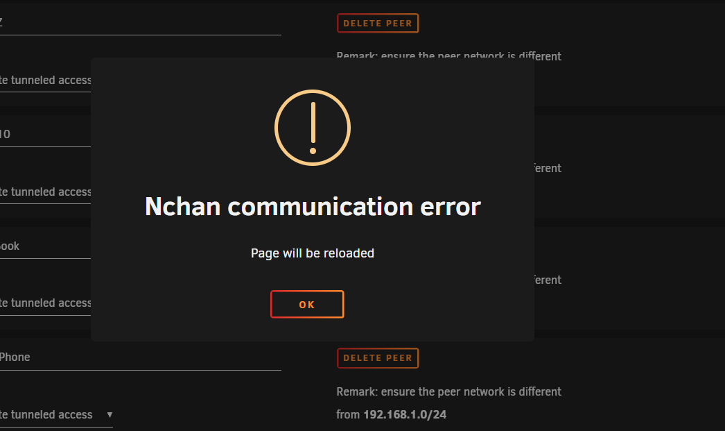

can someone explain this? or how to stop it form popping up every 5 seconds when connecting remotely form outside  network?
just happened after installing rc3
Edited by TRusselo
There's an issue with some browsers.  The fix will be in RC4.  I use Chrome and have zero issues.
Likewise for me with Chrome; no Nchan errors or slowness in the GUI.  On Firefox I have lots of Nchan errors and slowness in loading the Main tab and opening a terminal session from the GUI.  For now, I am using Chrome for the unRAID GUI.
