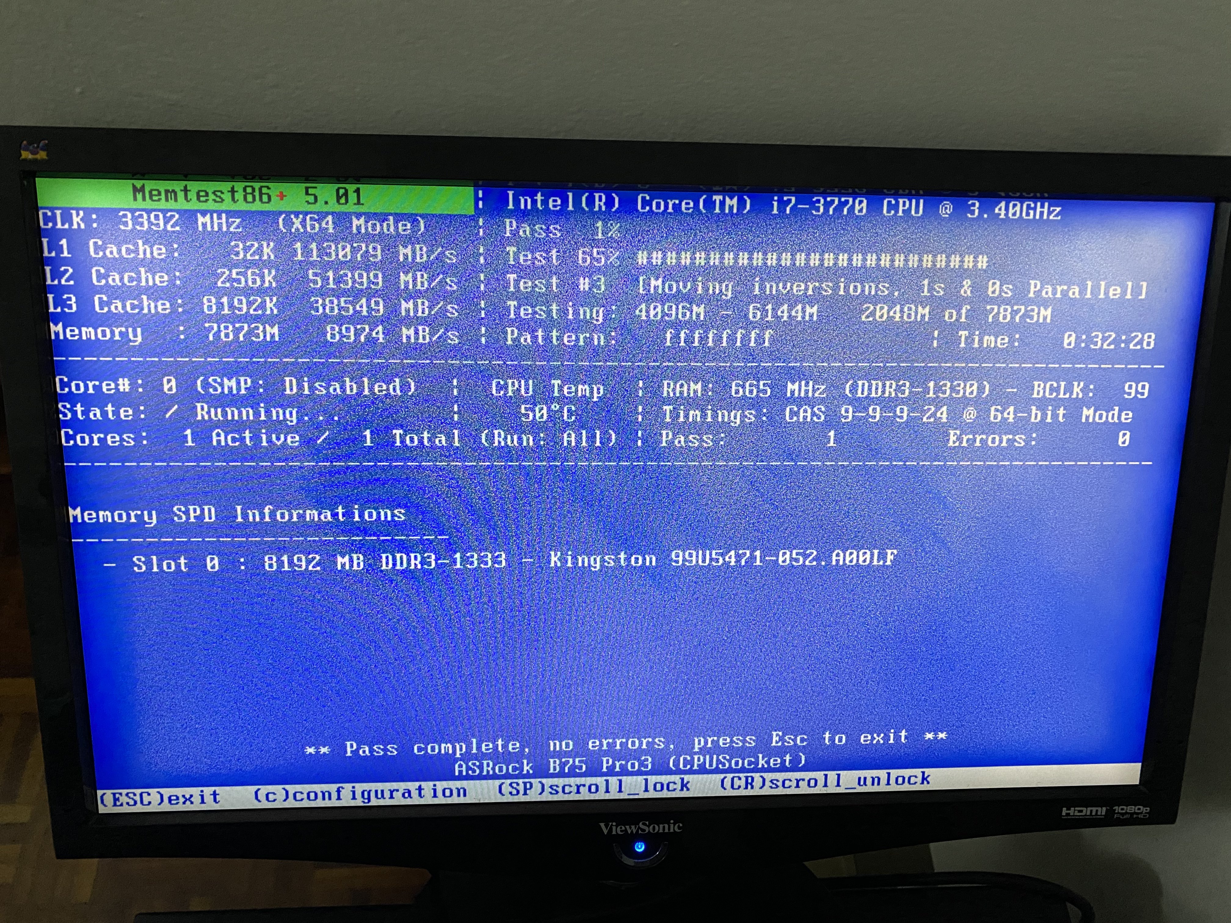

I found the offending ram stick, and moved on to the next one.
Test seems to be going a bit faster this way.
Memtest already shows “pass complete, no errors, press esc to exit” but it’s still running.
Do I need to wait? Seems like it’s starting another round of the tests.
  • Replies 52
  • Views 9.7k
It will keep running until you stop, if one pass found the error it should be enough, at least for now.
1 hour ago, itimpi said:
just to point out that you can get scenarios where all sticks test fine individually, but you still get failures when all sticks are installed at the same time.
Oh wow ok but I’m still testing the individual sticks tho. I’ve already found 1 with errors. I want to be sure the others are good.

Yeah I stopped it and testing the next one now.
