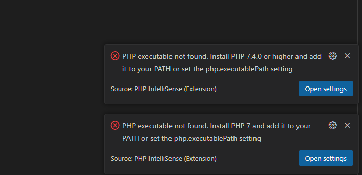

Hello,
Does anyone know how to solve this php error in the container "PHP executable not found. Install PHP 7 and add it to your PATH or set the php.executablePath" ?
13 hours ago, dianasta said:
Hello,
As the error states you do not have PHP 7 installed, to fix it you can install this in the container by editing the script in /config/code-server/scripts/example-startup-script.sh, the script explains what to do, if you get stuck let me know.
Excellent thanks works great!

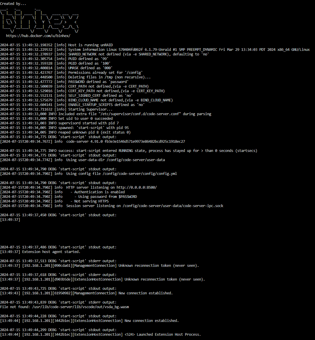

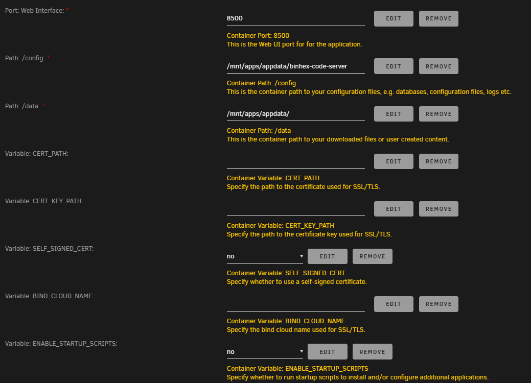

I must be blowing it because I get a permission error when saving. Any pointers?
When saving what to where?, screenshot and/or log would help.
Edited by sdballer
