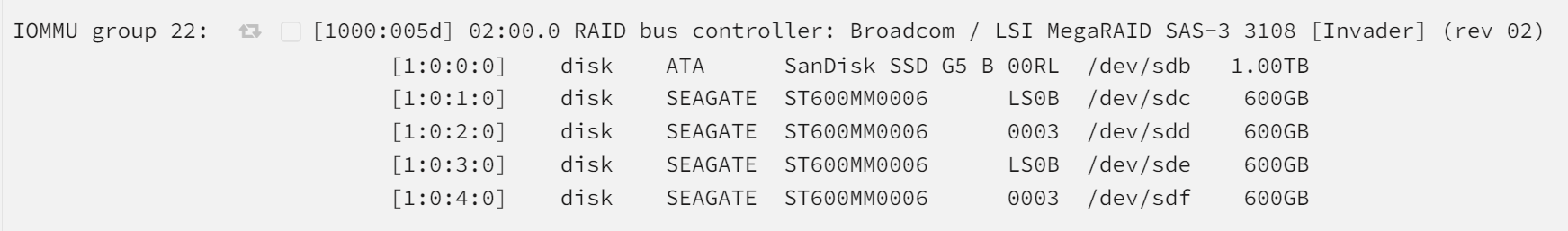

I just migrated from dell r420 h310 (LSI firmware) to dell r730 h730p mini (dell firmware) without any config changes.  Before hooking up the drives make sure to set the h730p mini to HBA mode by IDrac or bios interface.  AFter HBA mode is set power off... hook up the drives and you are done.
I run 4 cache sas drives and 1 unassigned ssd for appdata.  This is how Unraid reads it:
