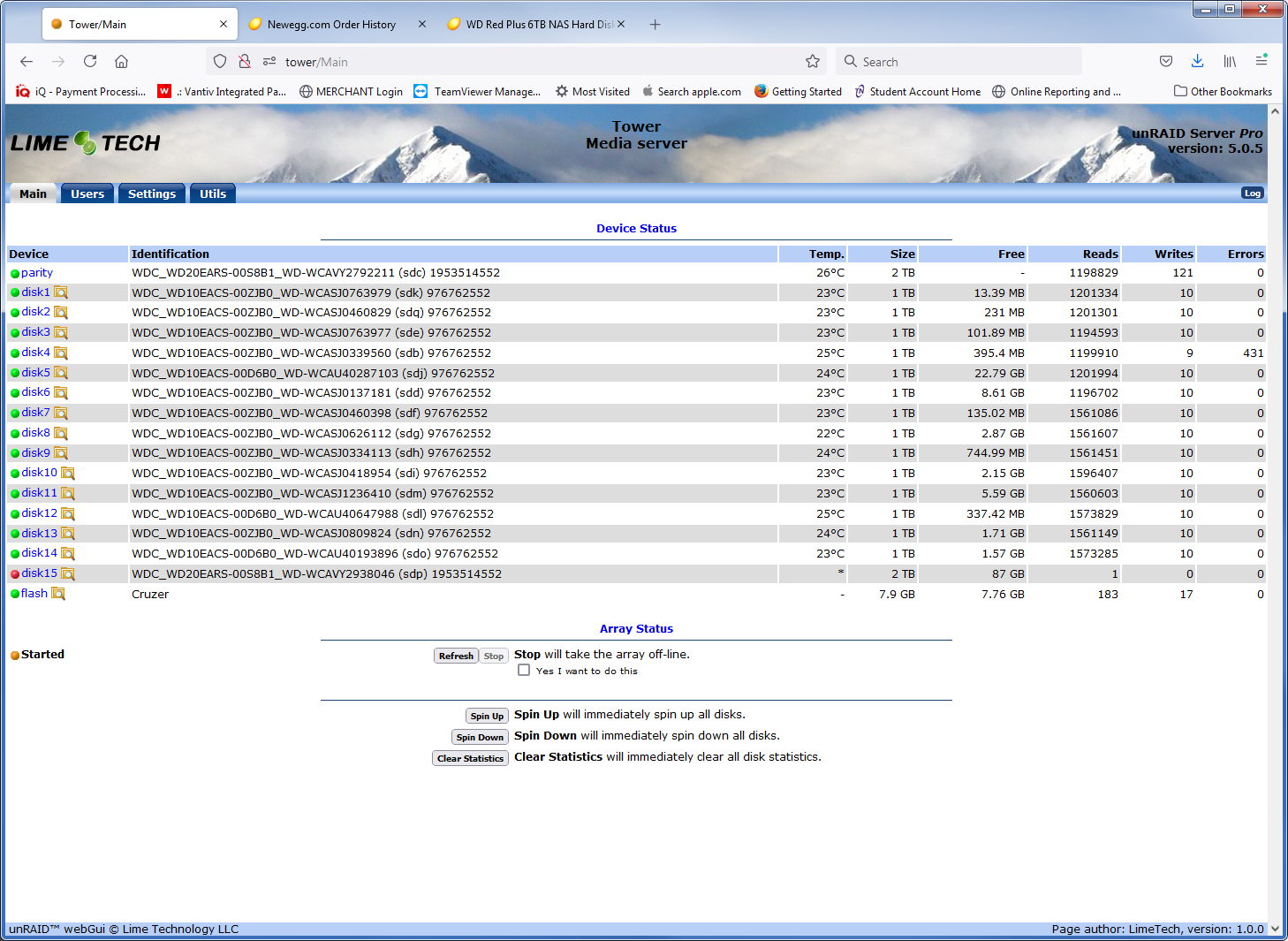

Red dot next to a drive
I just had a red dot appear next to one of the drives on the main menu.  I have stopped the array and rebooted the server and brough it back on line.  I CAN access the files on that drive but the red dot is still there.  What should I do next?

I think what may have happened is one of the drives ( think that one) got popped out.  The cabinet is a hot swappable (?) as I recall and maybe there was something in the buffer.  Is there a way to CHKDSK type of app to check the drive?
If you are using UnRaid v5 then the file system type must be reiserFs and the tool to use is reiserfsck.   On v5 it needs to be run from the command line.

This indicates a disabled disk and since it is emulated you can still access its data.

Filesystem check isn't the way forward for a mountable disabled disk.
Zip your syslog and post it. Also post the SMART report for that disk. Might be useful to know more about your other drives also since their health may affect rebuilding the disabled disk. How many disks do you have? Do you know if they are all in good health?
V6 makes it much easier to get us all the necessary information, and makes it very simple to see if Unraid thinks your disks are in good health.
So I can get on with the version 6 upgrade then figure out this disk?

You still didn't answer the question about your hardware, but based on the screenshot you just posted, especially with the read errors next to disk4, I think you are in a precarious state. My gut reaction is to tell you to make sure everything currently on the array that is of value is backed up elsewhere, before you start mucking around and possibly making the situation worse. I see from your browser tabs you are looking at new drives, I think that's for the best.
Ideally you should probably build another box and copy the data without disturbing the current server. I'm betting your current setup isn't going to be happy running V6.
Any data you care about on disk4 and disk15 needs to be copied to another location.
Your Pro license will easily transfer to a new system, and you can leave the current system intact while you copy data. All you need is a copy of your pro.key file.
Based on the syslog disk4 appears to be failing, post a SMART report for that disk, or update to v6 and post the diags, you should also change the onboard SATA controller from IDE to AHCI.
