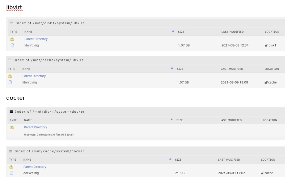

  5. And now my current problem, no dockers or VMs can be found, both GUI tabs are completely empty. I can still see all my appdata folder, VM disks and docker image files in the file system, but all the tabs in the GUI are empty suggesting there are no dockers or VMs

Your system share, where docker.img and libvirt.img is stored, now exists on both disk1 and cache. You should probably get rid of them and recreate or restore.
You can recreate docker.img and easily reinstall your dockers exactly as they were.
https://wiki.unraid.net/Manual/Troubleshooting#How_do_I_recreate_docker.img.3F
https://wiki.unraid.net/Manual/Troubleshooting#Restoring_your_Docker_Applications
I've not needed to recover libvirt but I think CA Backup plugin covers that.
Ok, thanks, although my docker.img is currently only on my cache and not on disk1

User Shares prioritizes the lowest numbered disk, and cache is lower than any of the array disks, so the libvirt on cache is the one being used, and it looks newer than the other one so that might explain why your VMs are missing. I noticed you had CA Backup plugin installed so maybe you had that setup to make a backup of libvirt.
As you noted, there is only one docker.img, that on cache, but it looks new also. The method in the wiki I linked to reinstall your dockers will probably be all that's needed to get those going again.
You should delete the system folder from disk1.
