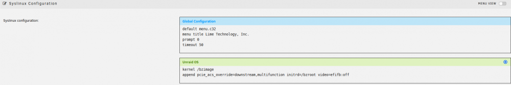

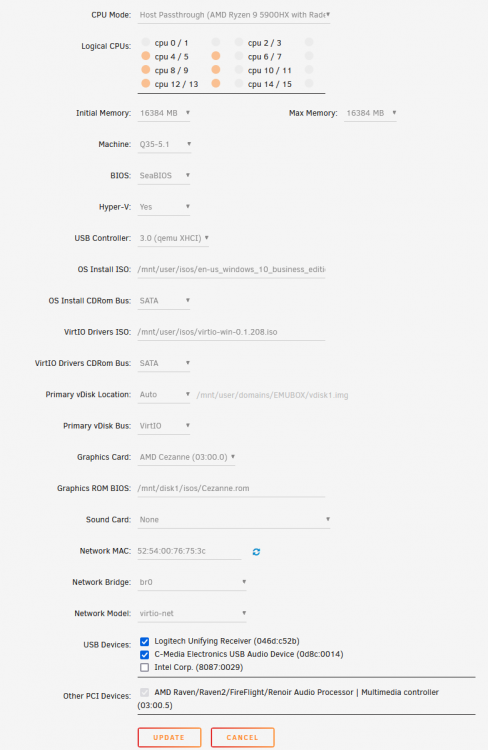

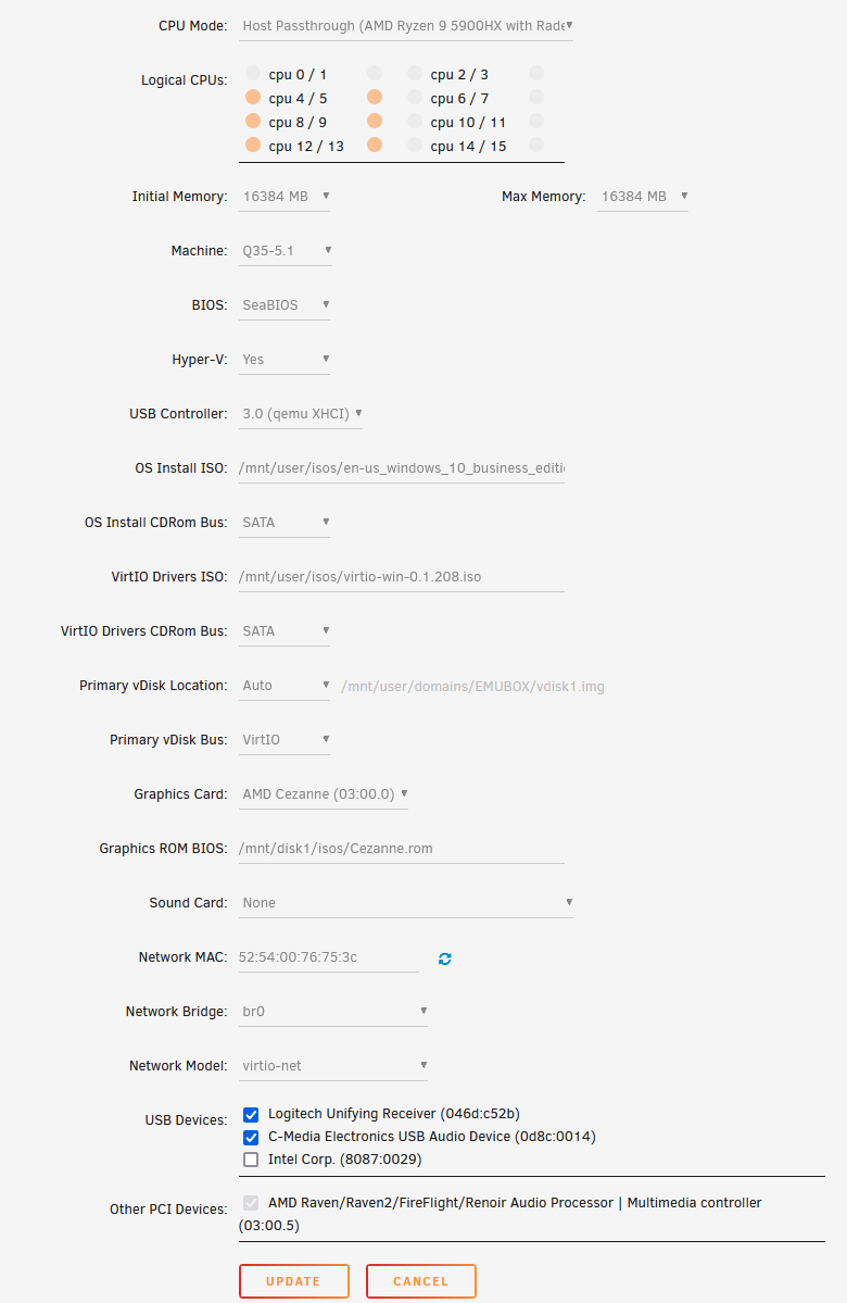

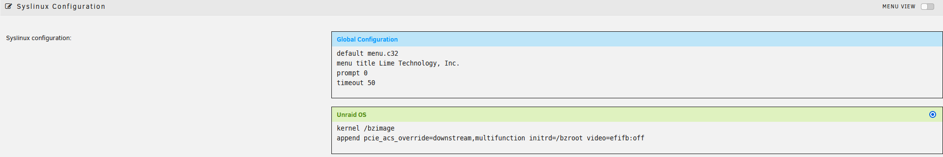

Thanks.  This worked for me, but the performance is pretty bad.  I get dropped frames in youtube 4k video playback.  This appears to be a non EFI bios, as I had to set the unraid startup flags to include "video=efifb:off".  I had to set my VM to use SeaBIOS in order to get it working.
Can I ask how you managed to dump the vBIOS? Also, I couldn't get HDMI audio working even though I've passed it through and the Windows VM can see the HDMI audio device.

Can I get you too take a screens shot off the vm settings ?.

Sure, here you go
And here's my syslinux config
Sure, here you go
