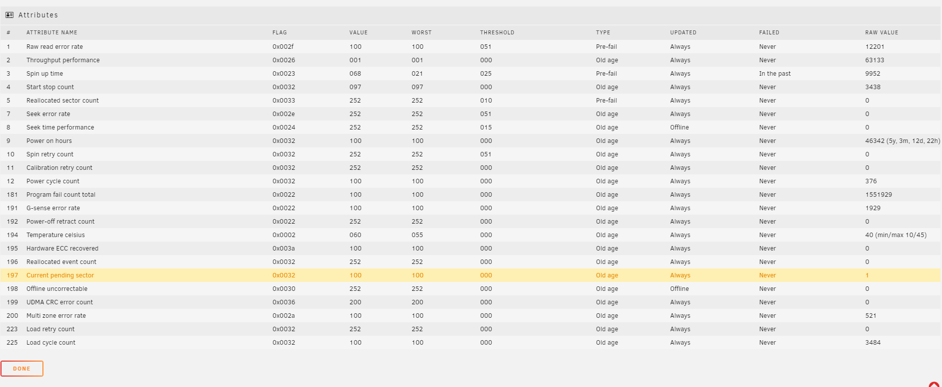

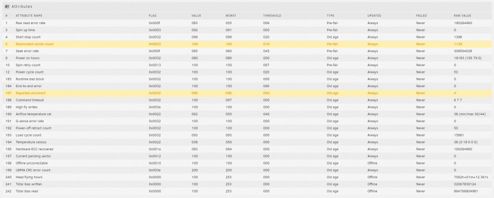

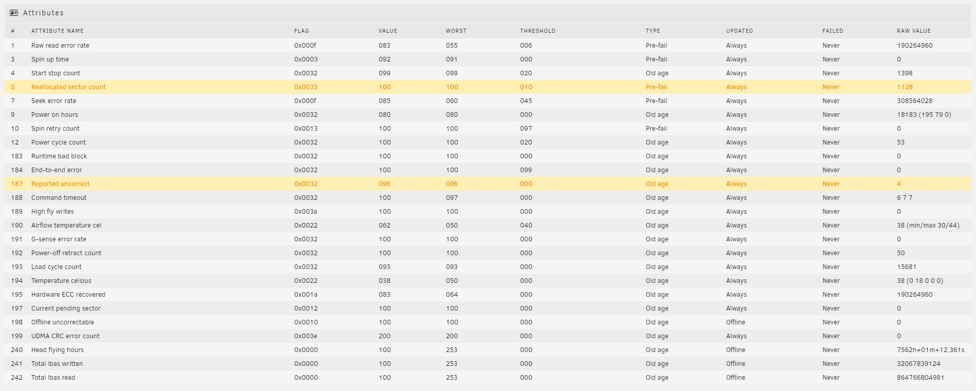

I still have a thumbs down on Disk 1 and before I had the crazy Disk 3 failure we were targeting Disk 2.
Attached the display of disk 1.  If I was ignoring things in the past need to understand better what I can acknowledge and what I should be proactive about.  Alot of the 2GB are older for sure

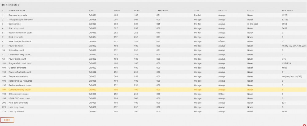

I posted my Disk 2 GUI for thoughts - I have drives now to replace it ;)
The other disks in the GUI have no orange lines  except 2 with UDMA CRC error count 30 and 21.

The pending sector on disk2 I hope doesn't cause problems for disk1 rebuild. I had a rebuild going when another disk suddenly got a lot more than that but it didn't seem to cause any problems.
Disk2 might even be OK to continue to use if you could get it to reallocate that pending sector. After disk1 rebuilds you could try to rebuild disk2 to itself, which should make it reallocate the pending sector and so change it to a reallocated sector, and a single reallocated sector isn't very concerning as long as it doesn't increase, since disks have extra sectors just for that purpose.
The large number of reallocated on disk1 is more than I would want in my array though and a reason to replace.

You could run preclear on the original that should get its pending sector reallocated.
I plan to do something the 8TB and 2TB wasnt sure what but will preclear and see what happens
