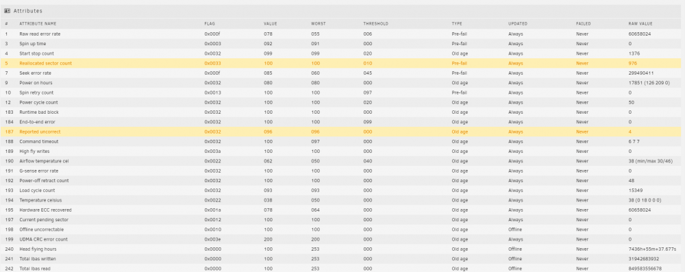

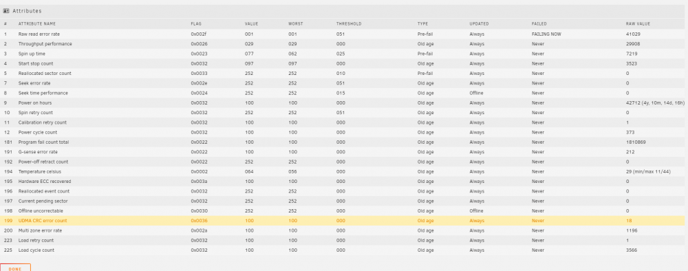

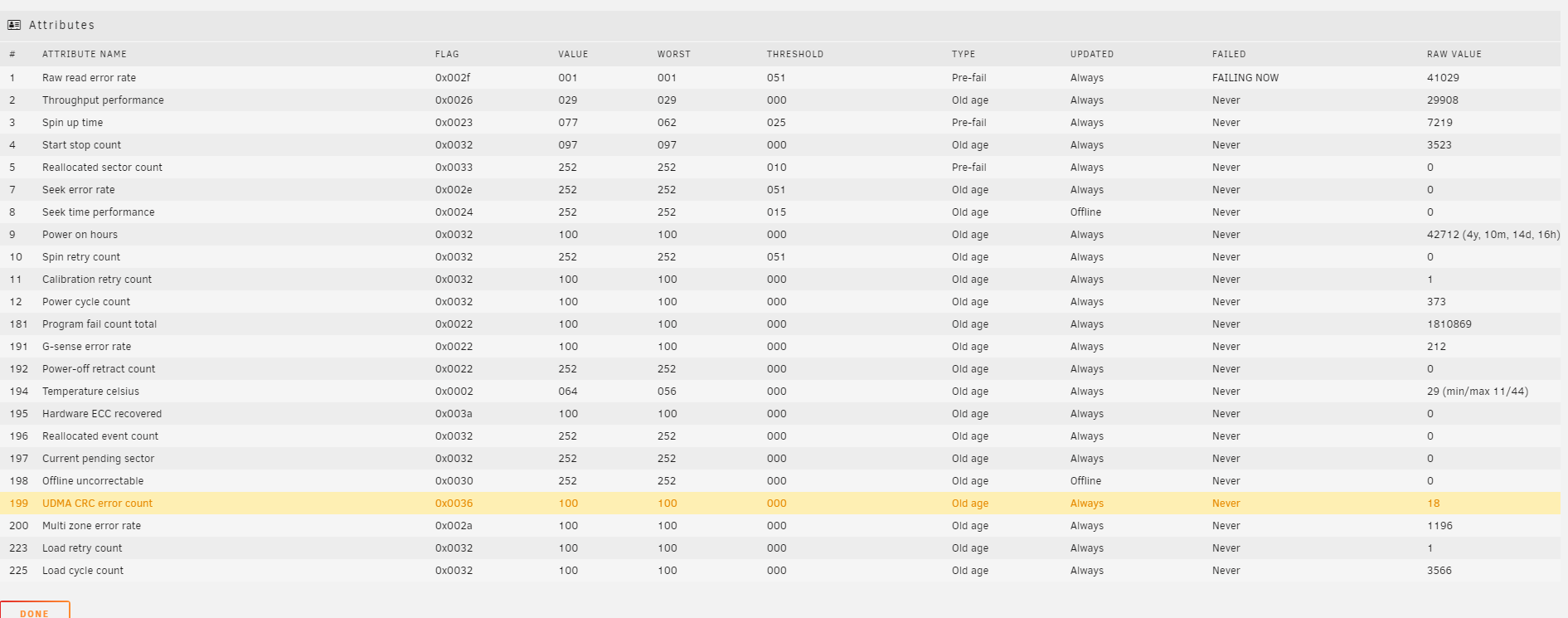

Serial Number:    S2H7J1BZB15127
ID# ATTRIBUTE_NAME          FLAGS    VALUE WORST THRESH FAIL RAW_VALUE
  1 Raw_Read_Error_Rate     POSR-K   001   001   051    NOW  41013
The SMART attributes are internal to the disks. Each disk monitors how well it is working as it is used, and records that in these attributes it keeps in its firmware. Unraid monitors some of these attributes by default and will warn you about those it monitors, but Unraid is only looking at some of them, and Unraid only reports exactly what the disk is telling it.
If the disk says it is failing, believe it.

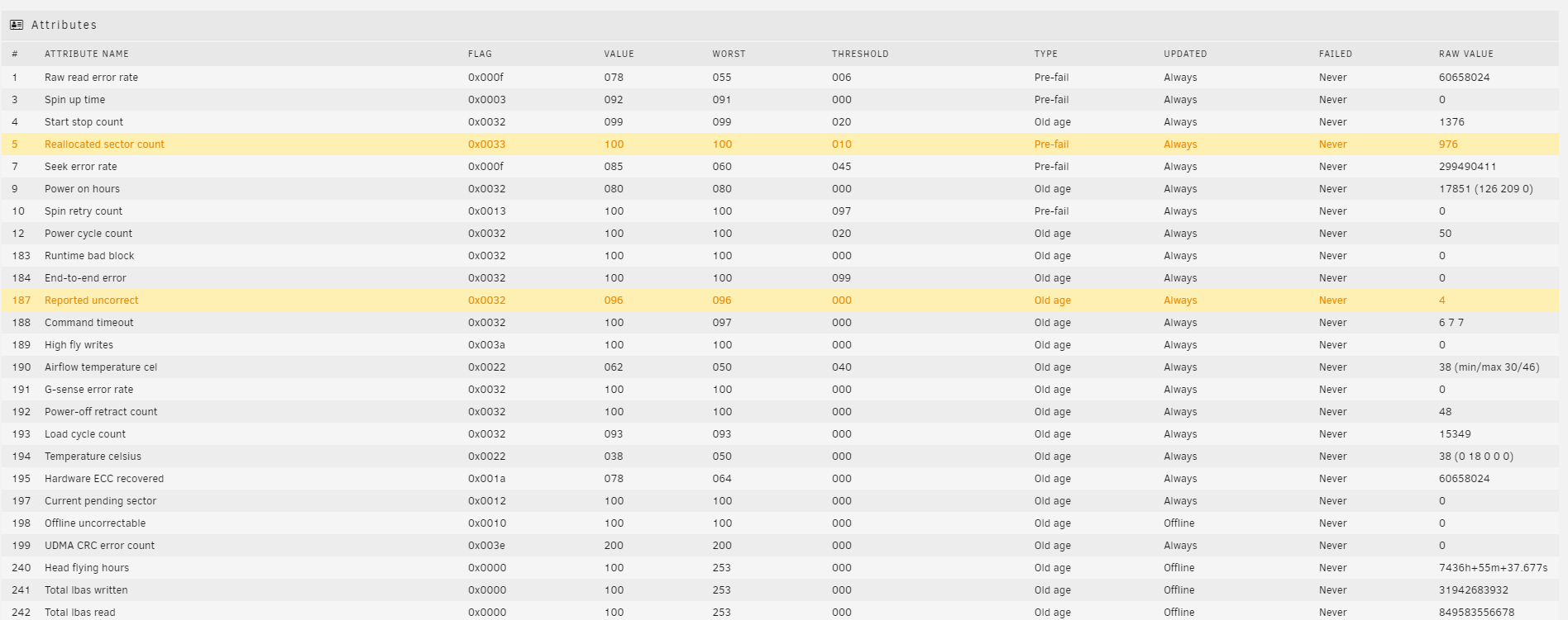

Serial Number:    ZCT0P3KA
  5 Reallocated_Sector_Ct   PO--CK   100   100   010    -    976
This one has way too many reallocated for my comfort. And this is one of the attributes Unraid monitors by default, so it should have been telling you about it.

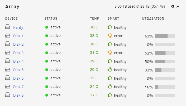

Do any of your other disks show SMART warnings on the Dashboard page?

That screenshot shows that on 2 of your disks, some of the attributes that Unraid monitors aren't good. So Unraid has been warning you about them.
The other disk isn't showing its problems because the attribute that shows it is failing isn't normally monitored by Unraid.
